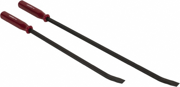

Manual trans won't seperate from engine
Discussion in '1st Gen. Tacomas (1995-2004)' started by Ironworker84, Mar 11, 2020.
  1. Mar 11, 2020 at 1:20 PM
    Ironworker84
    Ironworker84 [OP] Well-Known Member
    Nov 4, 2018
    #271625
    183
    Eric
    2001 White Tacoma 4X4
    I'm gunna skip straight to the point. Save everyone's time. What would cause the manual transmission to refuse to seperate from the 5vz-fe its attached to. The donor engine separated just fine from its automatic trans. What would cause this to be different?
  2. Mar 11, 2020 at 1:25 PM
    cosmicfires
    cosmicfires Well-Known Member
    Jul 17, 2012
    #82824
    3,190
    David
    Everett, WA
    2009 Regular Cab SR5 4cyl 5speed 4x4
    Snugtop cab high canopy.
    It's different because the manual transmission's input shaft goes into the pilot bearing in the back end of the crank shaft.
    The engine and transmission need to be aligned as you pull them apart.
  3. Mar 11, 2020 at 1:27 PM
    slander
    slander Honorary Crawl Boi
    May 10, 2013
    #103909
    8,964
    Hickory, NC
    02 Tacoma, fixed with curse words.
    Is the lower cover off? I wrestled with a trans under my truck for almost 2hrs until I saw that the lower cover was still on and getting hooked on the flywheel. 3 bolts later it was off.
  4. Mar 11, 2020 at 1:29 PM
    Ironworker84
    Ironworker84 [OP] Well-Known Member
    Nov 4, 2018
    #271625
    183
    Eric
    2001 White Tacoma 4X4
    How do I go about doing that?
  5. Mar 11, 2020 at 1:30 PM
    Ironworker84
    Ironworker84 [OP] Well-Known Member
    Nov 4, 2018
    #271625
    183
    Eric
    2001 White Tacoma 4X4
    Yeah I got the lower cover off. I thought that was the problem also. But it's still not breaking free. It's close. But wont budge any further
  6. Mar 11, 2020 at 1:31 PM
    slander
    slander Honorary Crawl Boi
    May 10, 2013
    #103909
    8,964
    Hickory, NC
    02 Tacoma, fixed with curse words.
    Look at the lower part of the bell housing, it's kind of a bitch to see if the trans is under the truck so you may have to feel for it. There is a cover on there that's held on by like bolts. You either need some flex head gear wrenches and a bunch of patience to get to the 3 bolts, or go in from the front of the truck with like a mile of extensions.
  7. Mar 11, 2020 at 1:45 PM
    Ironworker84
    Ironworker84 [OP] Well-Known Member
    Nov 4, 2018
    #271625
    183
    Eric
    2001 White Tacoma 4X4
    Yeah I got all the bolts off. I ve been trying to get a pry bar in between to break them free but i really dont want to fuck up the flywheel.
  8. Mar 11, 2020 at 1:57 PM
    tirediron
    tirediron Well-Known Member
    Jan 19, 2019
    #279864
    3,891
    John
    Victoria, BC< Canada
    2022 4x4 Sport, Auto, BCM
    Ehhh? Howzzat again Willis? The pilot bushing/bearing isn't splined, and if the trans is still attached to the engine, everything should be aligned unless something's seriously messed up.
    Is there any chance you've got corrosion on the input spline and it's fighting letting go?
  9. Mar 11, 2020 at 2:21 PM
    Wyoming09
    Wyoming09 Well-Known Member
    Apr 24, 2015
    #153833
    14,275
    New Tripoli Pa
    2000 Work truck 5 speed 4x4 3.4
    Super Springs
    There are two guide pins that tend to stick
    I made a special tool a 24" pipe welded to a chisel and tap between the engine and bell housing,.\\
    Is the wire harness disconnected on the right top that held one Transmission in so bad till I ripped the Harness apart
  10. Mar 12, 2020 at 12:25 AM
    slander
    slander Honorary Crawl Boi
    May 10, 2013
    #103909
    8,964
    Hickory, NC
    02 Tacoma, fixed with curse words.
    I have done that, just be smart obviously and use some gentle pressure and not donkey Kong it. Try messing with the trans jack tilt while you are doing that as well.
    Are you sure you got all the bolts off, including that one at the very top of the trans?
  11. Mar 12, 2020 at 7:20 AM
    Glamisman
    Glamisman Well-Known Member
    Oct 22, 2016
    #200436
    5,012
    more than likely the dowel pins... if you can get any clearance between the 2, a series of steel putty knives/flat blade screw drivers tapped between the seperator plate and the trans will usually work. It might take time and some PB Blaster on the pins... put some pressure on it and walk away for 5 minutes, a little more and walk away.
    AODRN and Ritchie like this.
  12. Mar 12, 2020 at 9:51 AM
    Wulf
    Jan 30, 2015
    #147523
    62,315
    rock raisin
    I would take a deadblow to the bell housing sides with alternating hits. Don't go overboard but the alternating hits can help break it free and make it start to walk off.
    I do the same to break third members free
  13. Mar 12, 2020 at 12:15 PM
    se7enine
    se7enine MCMLXXIX
    Apr 18, 2013
    #102322
    23,442
    Reno, NV
    I use this when it's stuck.
  14. Mar 12, 2020 at 1:00 PM
    Xbeaus
    Xbeaus Well-Known Member
    Oct 15, 2015
    #166775
    1,579
    Beau
    Black hills South dakota
    98 Tacoma 3.4 5 speed SR5 limited TRD 4x4
    Toytec coilovers. Height adjustable Bilstein's. 265/75/16 MT. TRD wheels. Rebuilt r150f. Marlin clutch kit. All kinds of new parts...
    I am not recommending this but - Mine was froze on there as well. I used a come-a-long to pull it slowly off. It was on a trans jack so it could move but holy hell. I thought I was gonna have to throw in the towel it was such a bitch to get off.
  15. Mar 12, 2020 at 7:18 PM
    paetersen
    paetersen Well-Known Member
    Dec 23, 2018
    #276726
    424
    ANY prying you do shouldn't be near the flywheel or ring gear. Only pry between bellhousing and block. Want really stuck? Try a subaru clutch job- aluminium to aluminium and so corroded together you are often at the seam with a cold chisel and a 3 lb sledge.
  16. Mar 12, 2020 at 7:21 PM
    #16
    Bishop84
    Bishop84 Well-Known Member
    Dec 17, 2015
    #172494
    12,094
    I warned you in your other thread :)
    cruiserguy and Wyoming09 like this.
  17. Mar 12, 2020 at 7:27 PM
    #17
    Glamisman
    Glamisman Well-Known Member
    Oct 22, 2016
    #200436
    5,012
    I hope it is just the dowel pins and not the input shaft/pilot bearing.
    cruiserguy likes this.
  18. Mar 18, 2020 at 9:11 PM
    #18
    Ironworker84
    Ironworker84 [OP] Well-Known Member
    Nov 4, 2018
    #271625
    183
    Eric
    2001 White Tacoma 4X4
    It was the dowel pins. I jacked up the motor a tad and it slid apart
    slander, Jeff Lange and tirediron like this.
