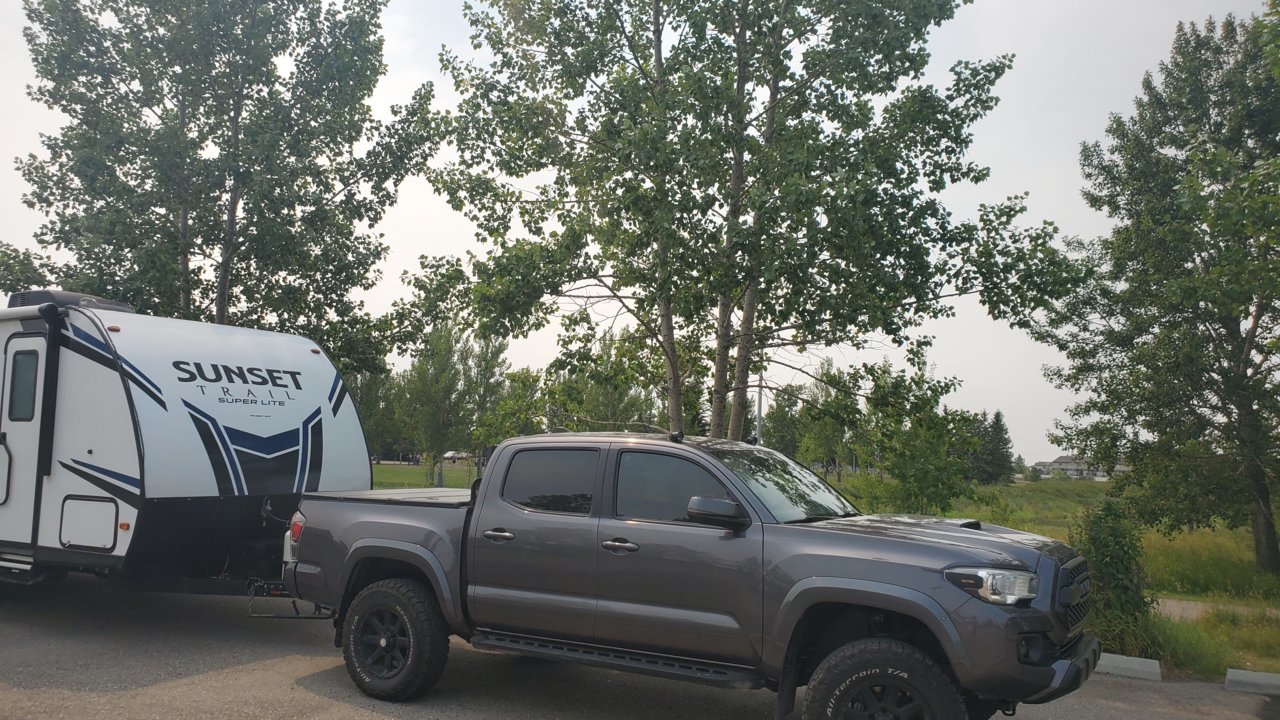

    I would say trailer towing has definitely accelerated it. Although a bit more time to drive and confirm post trip will confirm.
    I strained the Ole camry motor and transmission on the trip. If anyone knows the Alberta to BC highway, there are some decent extended grades during the drive. A bit of practice on the down shifts and knowing the which gears for the hills though the Taco did well I thought. Not the fastest but able to keep a safe pace anyways.
    For steep grades I held 3rd gear at about 80km/h and kept the RPM and pedal to about ~3k. That seemed to be the money spot for hills and kept shifting to a minimum.
    I was watching the MPG for fun also and noticed I might get worse MPG in 6th gear on flatter roads with pedal almost fully in, Versus staying in 5th and keeping in about half way to the floor. Averaged about 12 MPG on the trip. Never over 60mph /100 km for longer than a minute or two. The trailer (single axle) and Taco settle in nicely around 90-100.
    Funny you mention aftermarket parts though. I was thinking the same thing but after some reading on here as usual too much TW anxiety followed lol. :pccoffee:I'm not ruling aftermarket out but OEM is my hope at this point...just can't find enough info and support on aftermarket.
