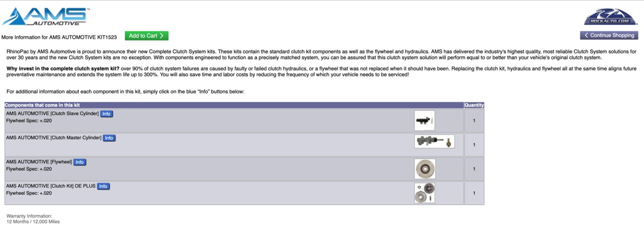

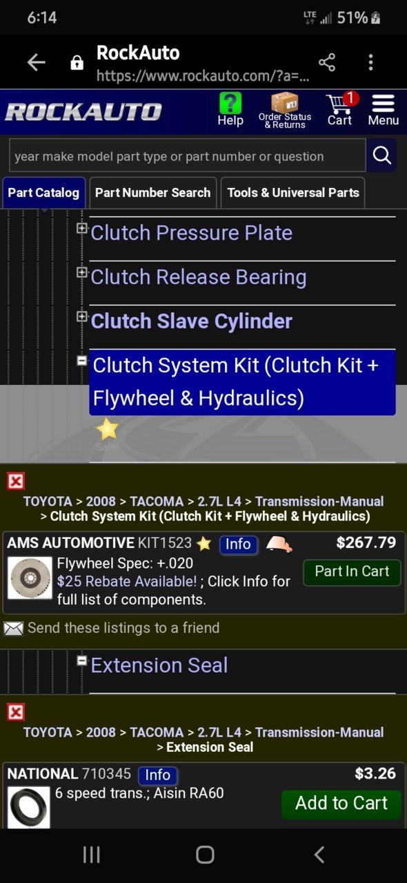

    Looked white to me. Is this the kit i need?

    Yup. That also includes the flywheel, so no need to have the old one machined.
    It actually has a lot more than what you need. That's for a full replacement to include the master and slave cylinders.

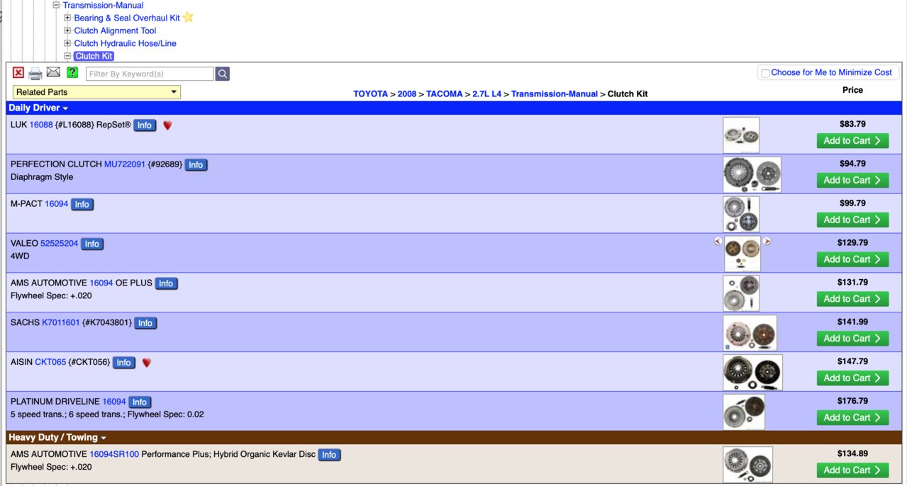

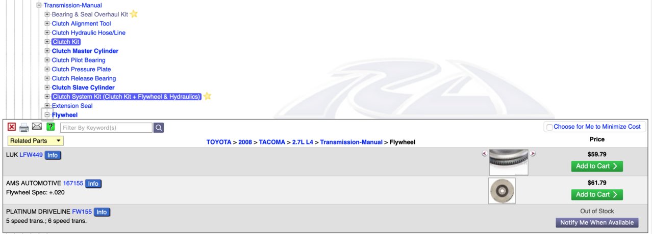

    Scroll up on that RockAuto page and click on the submenu "Clutch Kit" and select one there then go down to "Flywheel" and select one there.

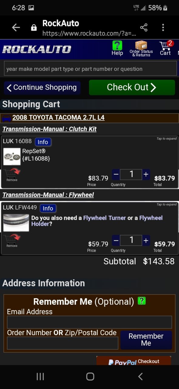

    Ok so this is right? Does it matter what flywheel?
