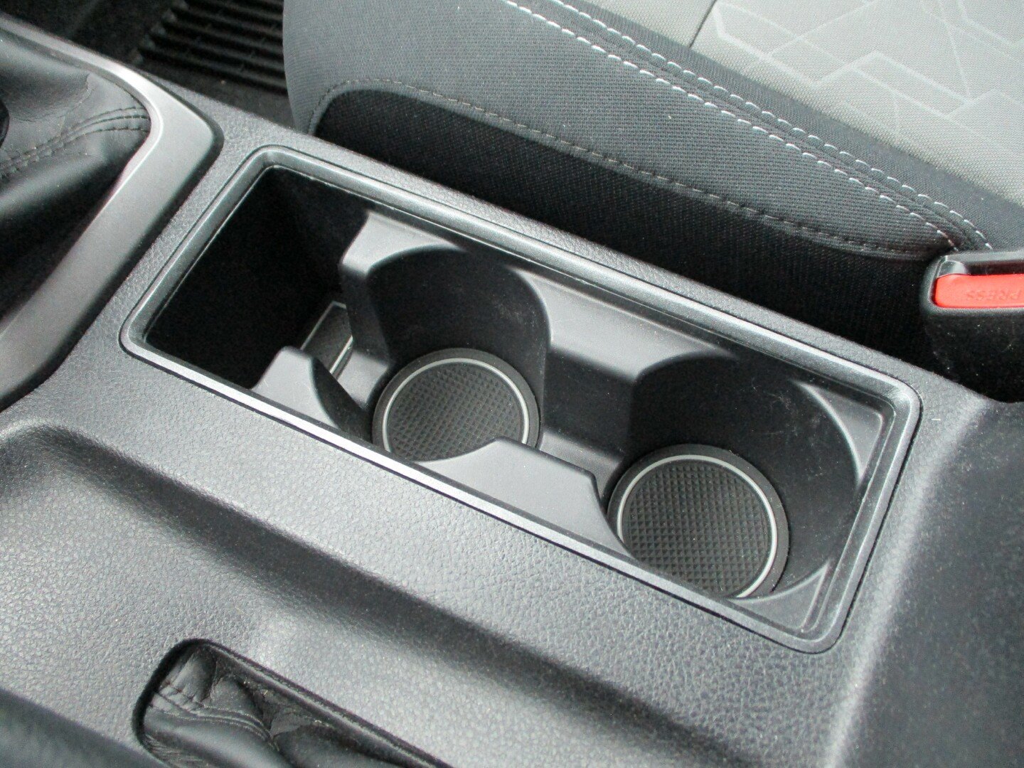

    Strip the chrome and paint the piece with Duplicolor Magnetic Gray Metallic to match other parts of the dash. That's what I did:
    To strip the chrome, you take out the trim piece (it pulls straight out -- you don't have to disassemble the console) and immerse it in a bath of strong bleach and Drano for at least two weeks. The chrome plating and the copper substrate eventually flake off. The underlying plastic is black. If that's what you want, you don't have to do anything further. Just snap it back into place. I think it looks nicer painted in the slate gray.

    Paint doesn't adhere well to the chrome plating, even if scuffed. Take a little extra effort and strip the chrome.

    That looks pretty good. I have the inferno orange dash trim but it does look to be matching the trim around the MT

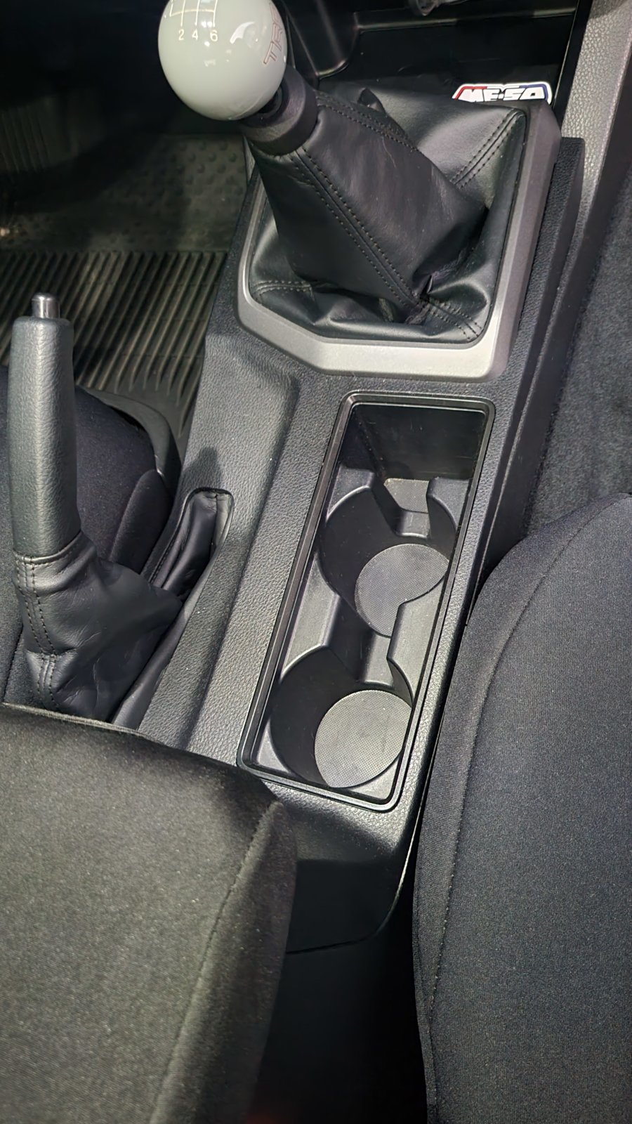

    I used plastidip on mine, and used the plastidip clear coat over it. Came out good and looks way better than the chrome20231125_174338.jpg
    doublethebass likes this.
