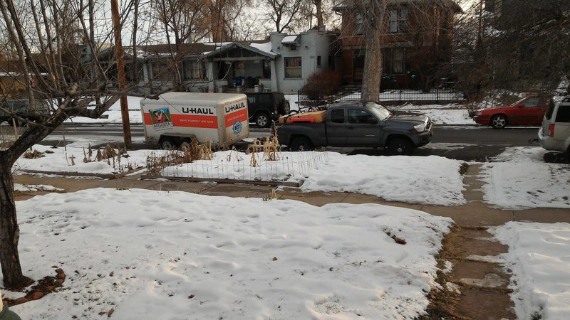

    This was about 5k lbs. About 550 lbs in the bed (telescope (wooden box), 21 gallon air compressor, steel truck jack) and various stuff in the cab plus me at 250 lbs + the heavy uhaul trailer 6x12 which is 1.9k empty and was filled to the brim, double stack tool chest, summer wheelset + rims, bed, grill, books. Stock leafs sagged like a mother but it did 120 miles across the foothills of the mountains when I moved last January. Kept it about 60-65 mph in 5th, 14mpg. It handled it really well and you knew it was back there and while stopping took a bit longer the brakes didn't feel overloaded. Engine braking definitely helps, and while I loaded the trailer pretty nose heavy it towed very well.
