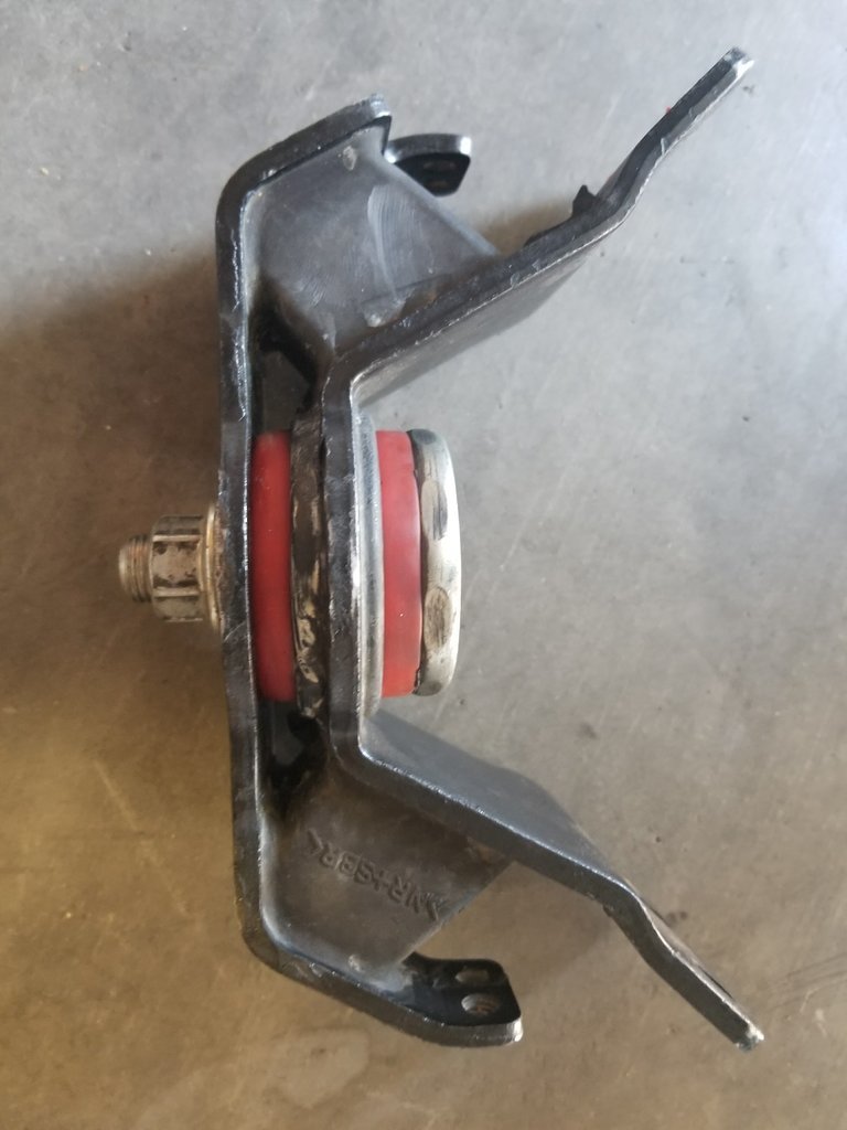

    There are no changeable bushings in a stock Toyota transmission mount. It is 8 bolts and swap it out. 2 on each side of the transmission and 4 through the cross member.
    You can buy a heavy duty mount from some where like 4xinovatiovs with Poly bushings if you want to have a mount with changeable bushings. Living with one of these in a daily driver is abysmal at best. They are great in a dedicated off road truck or a race truck but that is not under discussion here. The heavy duty mounts with poly bushings are going translate more vibrations to the chassis than a stock mount that is poured full of shore hardness 50-60 polyurethane.
    I have mentioned this before in this thread and have been filling stock Toyota mounts with urethane for a decade or better. Doing this works well for shoring up a mount and keeps the vibrations down.

    This is how I got to poly filling the trans mount. I guess I should have clarified the part of the post I was referring to.
    I had the clunky 1-2, 3-2 shifts. Did this to mine and no longer have the issue.
    The poly in my experience out last the rubber in the stock mounts.
    To the best of my knowledge there is not an aftermarket trans mount currently available for a third gen so this is a viable solution to the issue.

    I haven't acutely tested the shore hardness of the stock trans mount rubber but from my experience I'd say that they are in the 40-45 range. There is also a very large void in the mount for movement. The combo of those two things lets the torque load up pretty good in the third gen trucks. When you lift, clutch and shift you get a noticeable clunk from the torque unloading and the mount rebounding against it. Filling in that large void in the mount with poly remedied the issue that I had with mine.

    This is how I did my trans mount. I used ES radiator core support bushings sandwiched in the void of the mount, then cranked down the bolt. It pairs well with the solid motor mounts. Trans doesn't move around nearly as much now.

    Would you happen to have any pictures of the process? I haven't found an aftermarket mount yet either for the 3rd gen so I guess it would be a dealer trip to get a spare one to try out.
