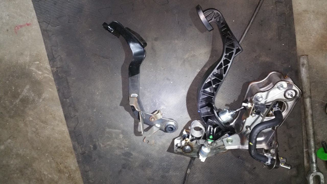

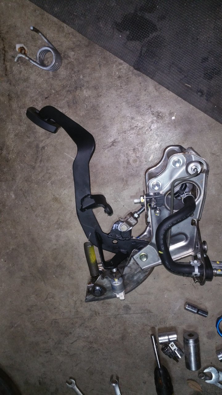

    Still unsatisfied with the level arm itself however, I did some digging...
    As it turns out, fortunately for me, the FJ cruiser uses a steel clutch pedal with the same mounting pin as the Tacoma, so I purchased one from the dealer and a few different iterations of cutting welding, readjusting, bending etc I now have a very light throw, low pedal, with short travel, a linear spring for tension, and it feels SOLID! No lateral play, it's smaller in body and has plenty of room for me to get my feet behind or drive with my boots on. Much less stress on my knee and ankle as well. I can actually use the clutch and keep my heel on the floor the whole time lile the brake pedal.
    Out with the old in with the new.

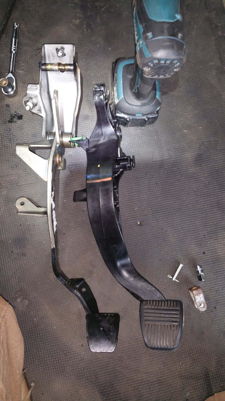

    Unmodded side by side:

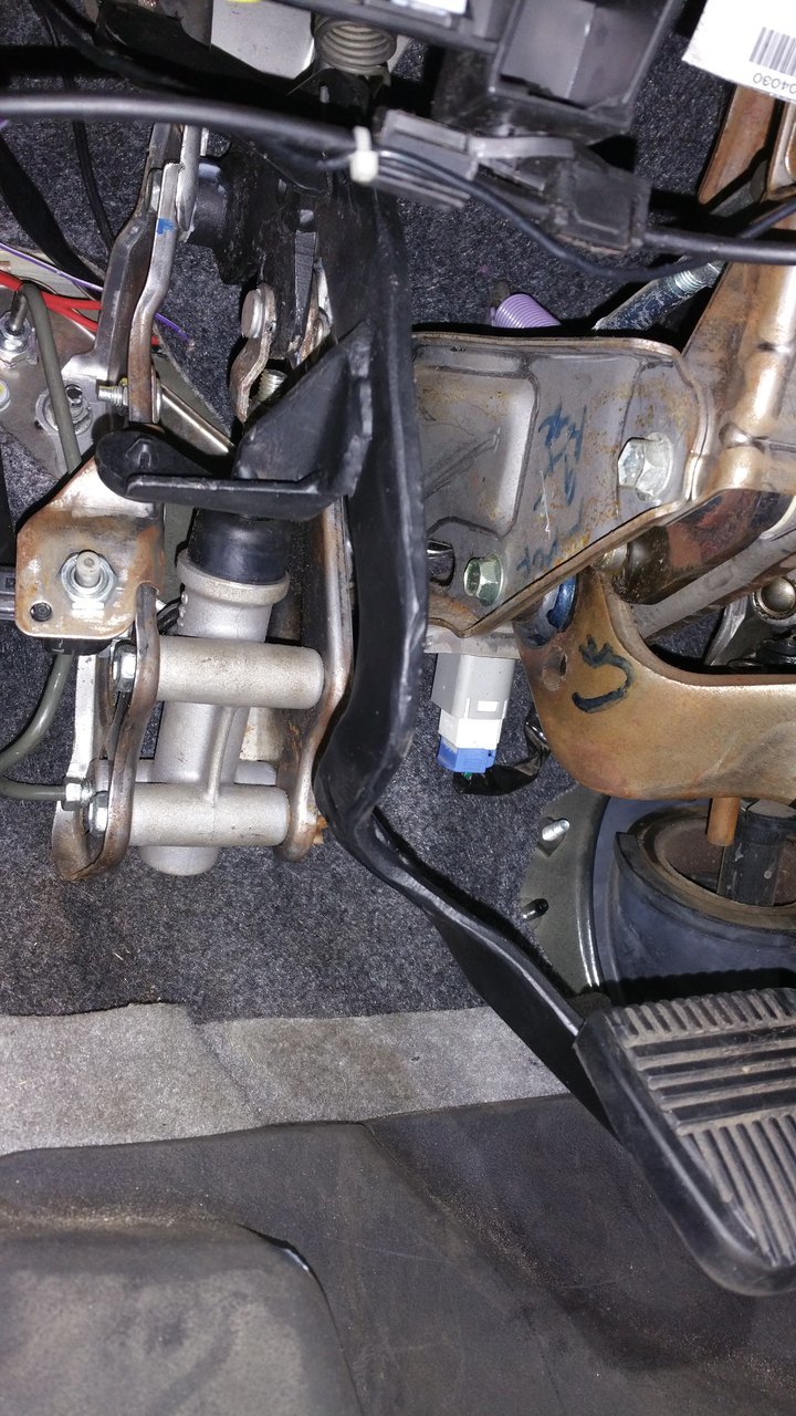

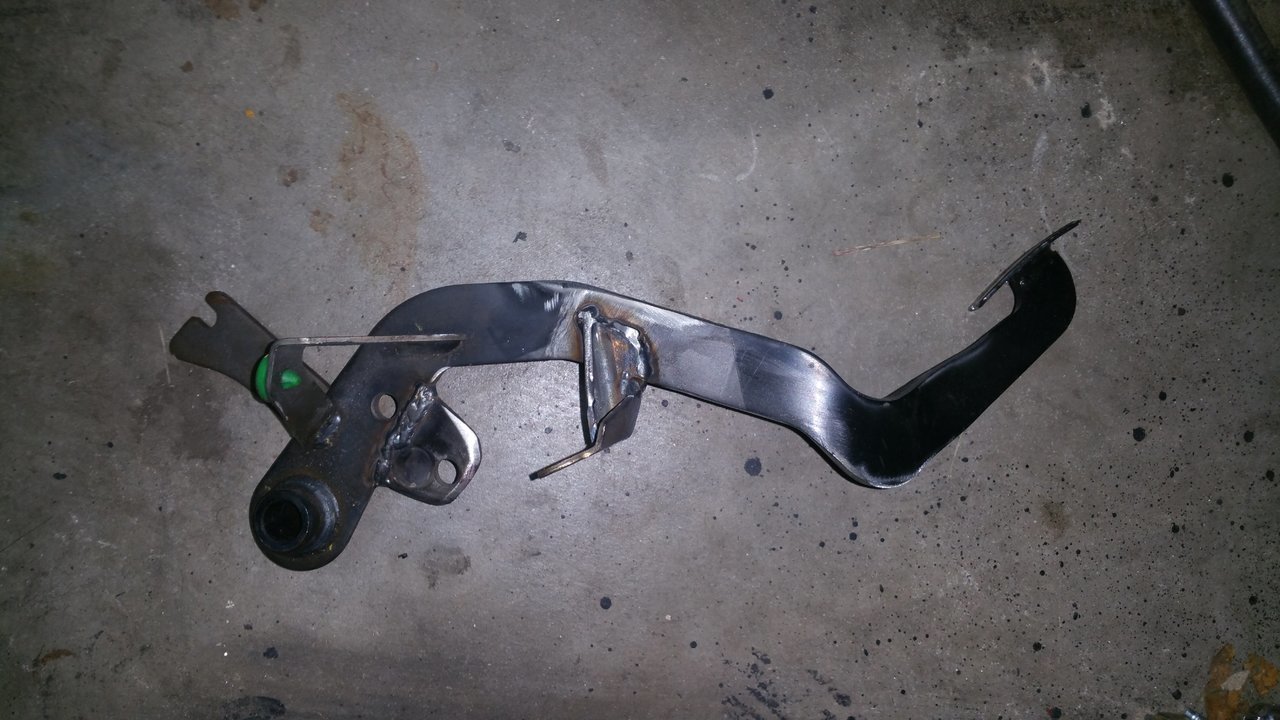

    Ran into my first snag, it seems the FJ uses a different or in the least a differently angled MC, having just upgraded to an alloy MC and given how much a PITA removing the clutch pedal brackets and MC was I decided I would make it work.
    You can see here I added the hump on the bottom to get the MC to hook up to the pedal with a clevis and the right height and angle.
    I removed the spring horn from the pedal and had to modify the clutch down and up switch pad poles to line up, again given the FJ sits more vertically vs the Tacoma's more reclined driver possition it seems the pedal assemblys are angled differently. The FJ pedal seem like it's more of a step down onto it vs the Tacoma is more of a push back toward the firewall.
    I'd like to see and drive a 6speed FJ to confirm this.

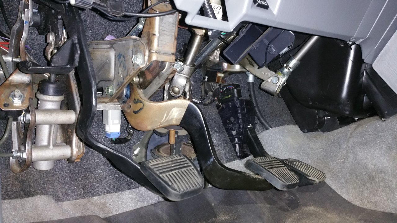

    I drove it in the above configuration for some time but decided the pedal rode too high and too far left, so I finally had the opportunity this past weekend to take it out and fine tune it to my liking resulting in the below:
    Couldn't be happier with how it feels now! :D
