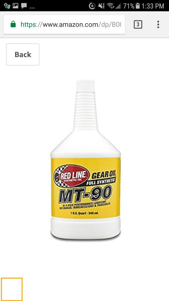

    Doing the rear diff fluid today.
    Thinking of picking up some of dis.
    Read on here awhile ago some aftermarket fluid will help with the howl. Bonus.
    Any other reccomendations for aftermarket non OEM stuff guys?

    75w-85 is the correct Rear Diff Spec if I am not mistaken, and the fluid will not cure the Howl, that is a Harmonic Vibration.

    I have MT-90 in my tranny. No complaints.

    That’s MT-90 GL4 don’t put in your diff it’s manual trans fluid. Use 75W90 or the spec 75W85 GL5

    Oops. Thanks for that. I thought like automatic fluid it can be used elsewhere.

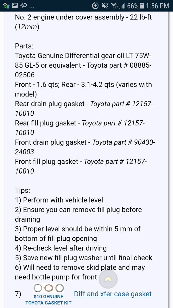

    Thanks for help. Im doing the front anyways so the rear is coming out too. Same weight oil for front and rear diffs according to what I find on here correct? Screenshot_20180407-135645.jpg

    Same weight 75W90 GL5 front and rear. If you need a synthetic in a hurry just buy Mobil 1 which you can buy anywhere.
    Don’t worry about the spec 75W85 weight unless you’re driving highway all the time.

    This is what I used for my truck:
    Front Diff: 1.6 qt - Redline 75w90
    Rear Diff: 2.5 qt - Redline 75w90
    Transfer Case: 1.1 qt - Redline MT90
    Transmission: 2.0 qt - Redline MT90

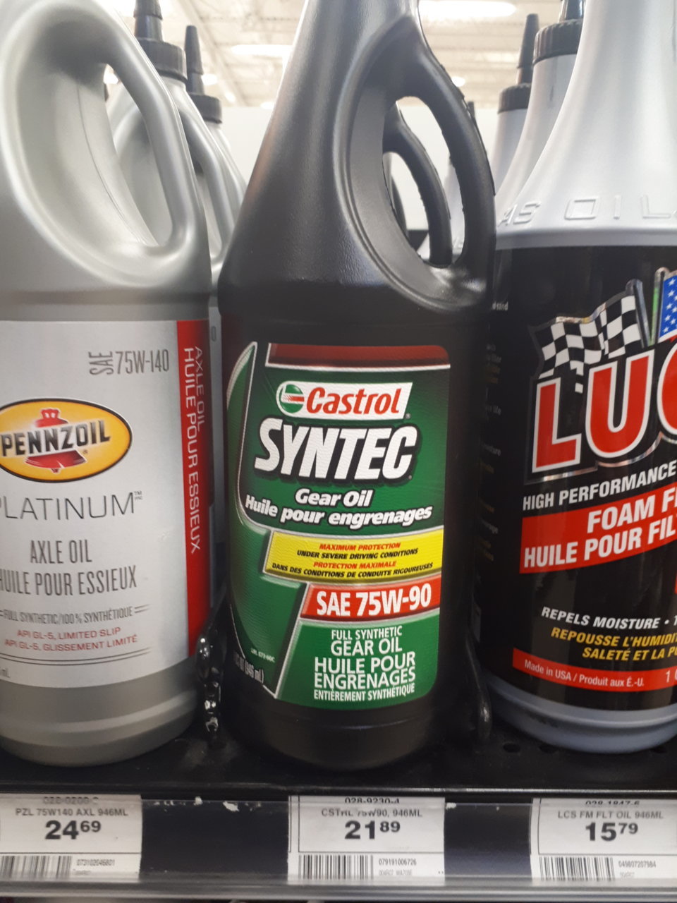

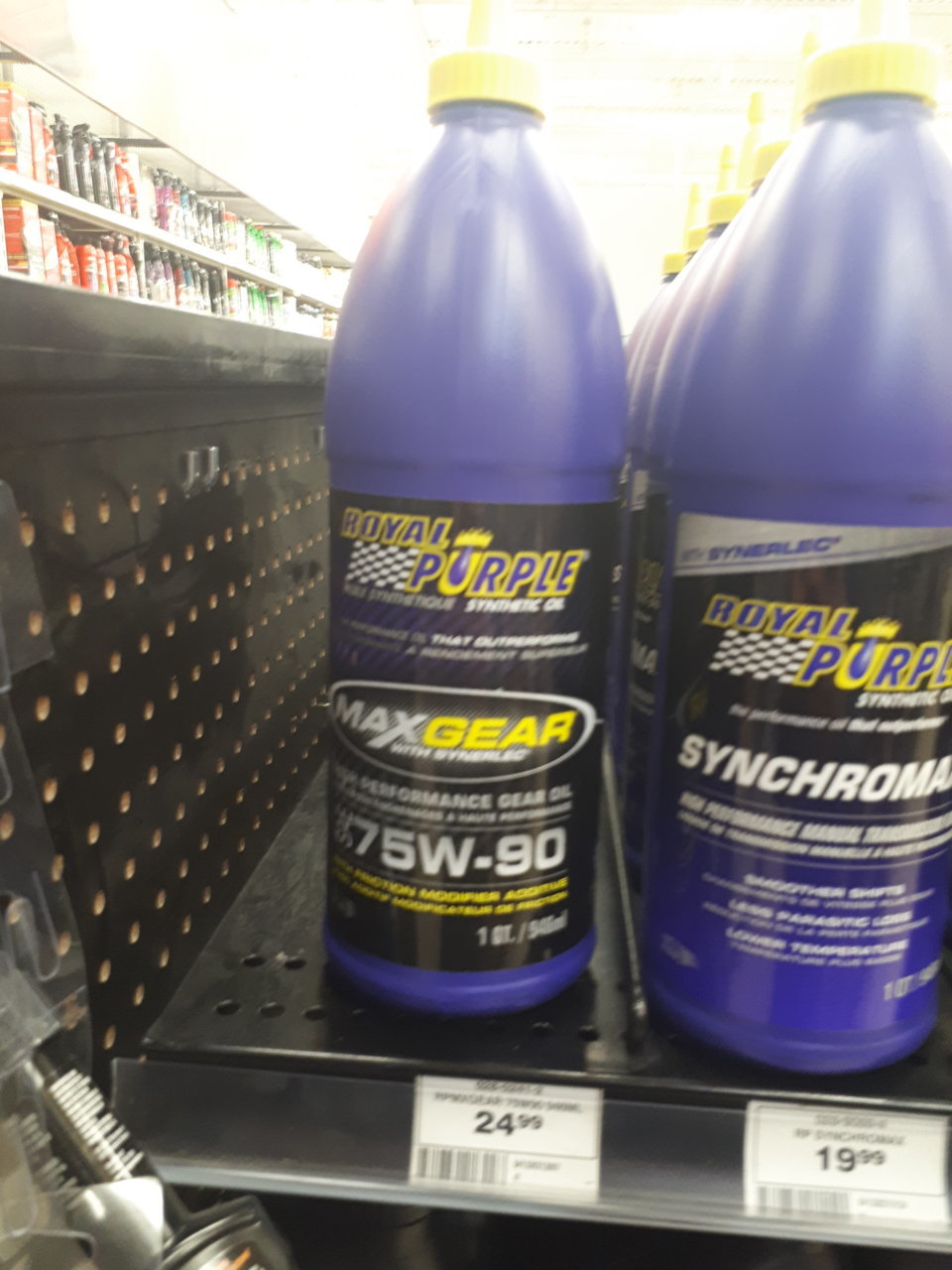

    Well Im going with some "liquid engineering" gold.
    :burp:
    Was Castrol or Royal Purple as choices around here.

    I use Royal Purple engine oil. Many people don't seem to be a fan of their gear oil though.
