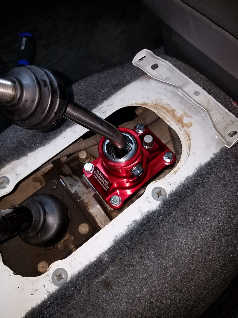

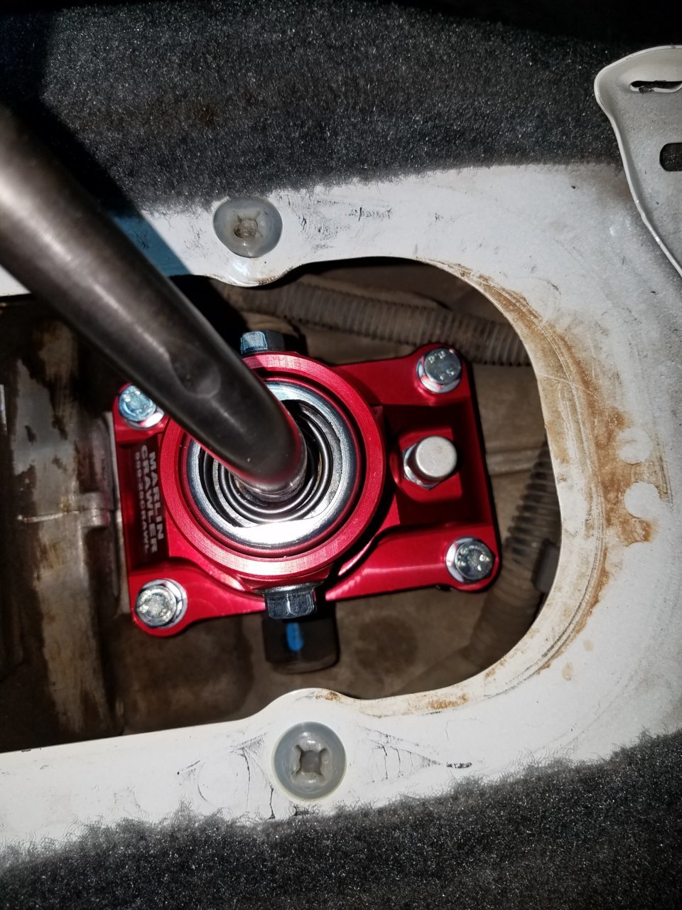

    Rancho Quick lift. Wheelers Off Road Progressive AAL with Rancho RS9000's, braided brake lines & clutch line. BFG 32x11.50 15 All Terrain Tires Deck Plate Mod. Flowmaster 60 series muffler and Marlin Crawler Short Throw Shifter.
    I have a hand shaker in my 96 4x4 Xcab and I love the short throw shifter I installed. That might be a little ricey but I don't care and I wouldn't have it any other way!
