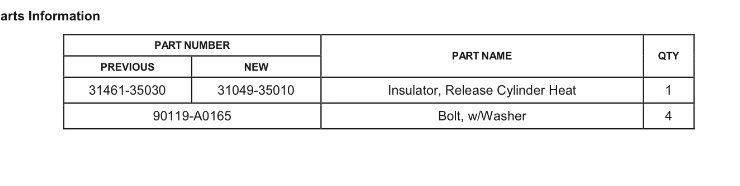

    100 is worth not arguing with a retarded service rep. Can you post the parts.

    My thoughts exactly. I did a little looking yesterday and it seems every place wants about $100 for the part $20 shipping. I haven't seen any posts of anyone who did this yet and if it made a difference but I'll probably give it a shot

    I never noticed anything wrong before this part was installed to my truck.

    Do you have this high pitched sound? Mine happens at 45 and 60. It is a faint high pitched sound that is very speed specific. I can replicate 90 percent of the time. It was present from day one of ownership. I have gotten used to it and just avoid those exact speeds.

    I know I can just simply take the heat shielding off the side of the transmission and the whine goes away. Until I remove my rear cats I am just going to live with it. After I remove them that heat shield is going in the scrap barrel.and I’ll build a simple aluminum heat shield for the driver side exhaust tube.

    I’m fairly sure it’s this. Very easily reproducible on my truck. Usually in the 55-60 range, I don’t remember the exact spot as I usually am doing interstate driving so I don’t hear it all the time.
    It’s often enough though that if $120 makes it go away, I’m all in.

    I was thinking about giving that a shot just to verify that’s the issue on my truck. Maybe if it stops raining here I’ll do that tomorrow and see what happens.

    Never had a problem with this noise. I've heard it maybe once or twice in nearly 15,000 miles if it's even the same thing addressed in the TSB . Do you guys have your front air dam installed on your trucks?
