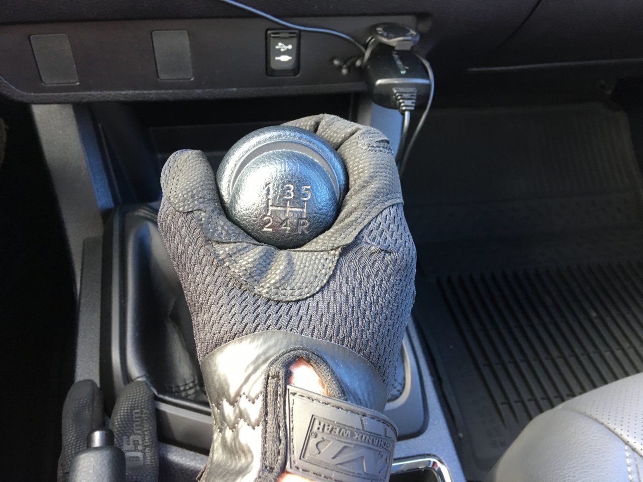

    Nice weight. Positive grip. Never hot. Cold as hell in winter.

    Congrats on the 5-speed, you got maybe one of the last ones ever made. Legendary Taco config, respect.

    Thanks
