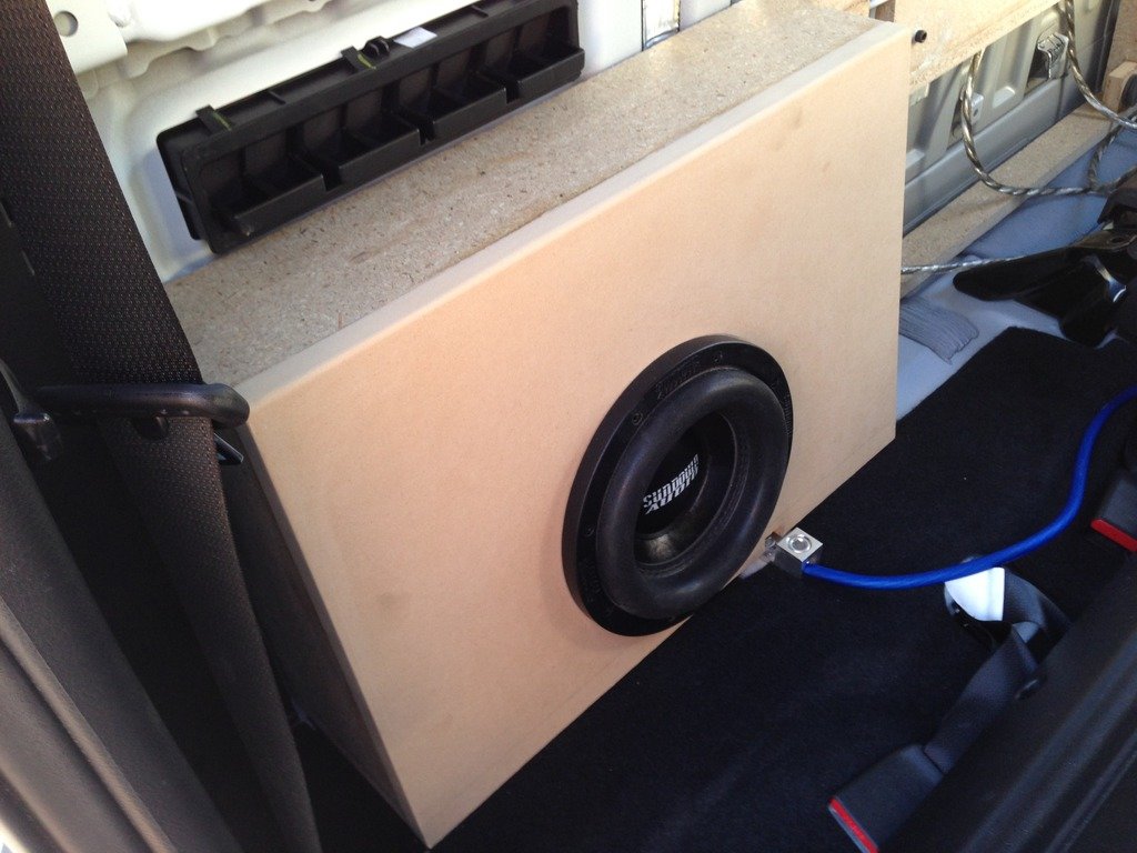

    I know exactly what is going on w/ rear noise..
    I'm working an audio build right now. Do u see the black box above the woofer? Those are the cabin vents.. When driving down the road , the tabs in the vents lift up, I can actually see the bed of the truck through the vents they open up so much.. This pores a lot of road noise into the cabin..
    The fix hopefully will be Mass Loaded Vinyl material over these areas.. Can't plug it up though! That will cause issues..
