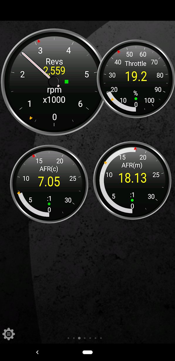

    When you pop in that tune, what throttle percentage are you seeing while coasting?
    No problem! That was the most informational post that I have seen. Something explanatory like that earlier would have helped me more.

    No worries! It can wait until you see the tune again. Also, any impressions that you have of the engine braking.
    7% would be killer. I would see a min around 15% to 17% with the injectors on or not. I would get a bit more braking once the injectors do turn off.
    Given the craziness of the system, I could not figure out if that was the actual plate or something else, but I did know that it was too much.

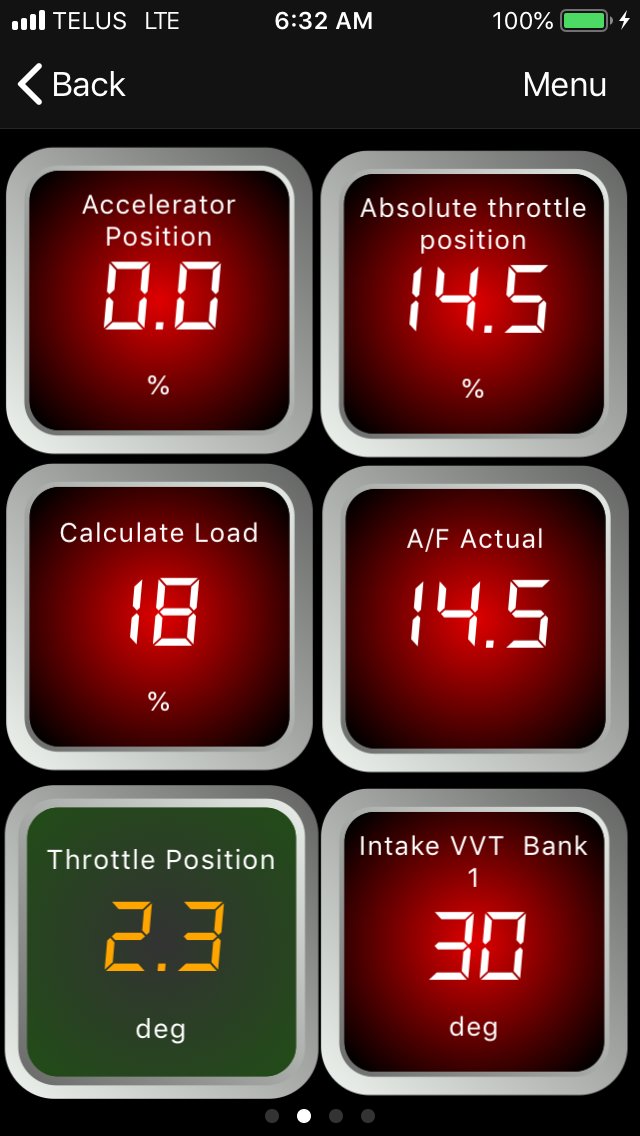

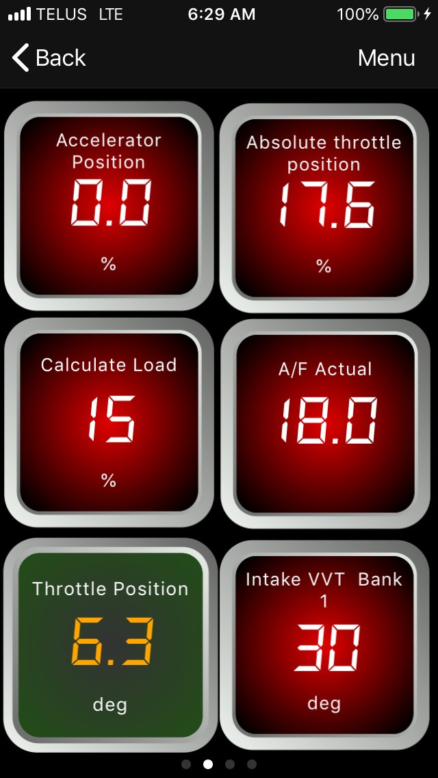

    OVT 1.05 Modified Atkinson 91 Octane pre-release M/T tune loaded. Coasting (full lift) around 80km/h going down a slight grade. "Absolute throttle position" (in percent) is a SAE PID, and "Throttle Position" (in degrees) is a Toyota Specific PID in the app:
    Idling in traffic:
    It is interesting to note that while coasting and slowly decreasing speed, the throttle position value also slowly decreases. Cable throttle doesn't do that lol.
    Notes:
    1. A/F ratio while coasting is pegged at it's max value (max in the app or maybe PID), 18:1. We are in DFCO, folks (obviously). The engine isn't firing, it's being spun by my rear wheels.
    2. As Mat said in his blog, calculated load never drops below 15%, even while coasting!
    3. Intake VVT target angle is the same for full lift (DFCO) as it is for idle. It immediately snaps to 30 deg every time. I don't know what reference or position of the cams/crank Toyota uses for VVT angles.

    Thanks, but darn. Now, I'm confused again.
    That is interesting about the AFRs. I thought that I saw them peg out while coasting? That would have been pre-TSB.
    You were never out of the club. Hahahaha!

    Edited my post to state 18:1 (not %, duh) for that pegged out AFR lol. I didn't have my coffee inboard yet.
    AFRs always peg out while coasting (full lift) until you reach ~1300 rpm, or hit the clutch, or breathe on the throttle. OVT or OEM file, same thing. Sorry for the confusion. Makes sense, injectors are off when you lift.
    Again, we don't have a tune file yet with the engine braking enhancement Mat mentioned in his blog. Perhaps this next release will have that implemented :fingerscrossed:

    I found similar:
    This was while coasting in 4th downhill. I need to see what our Subaru says while coasting.

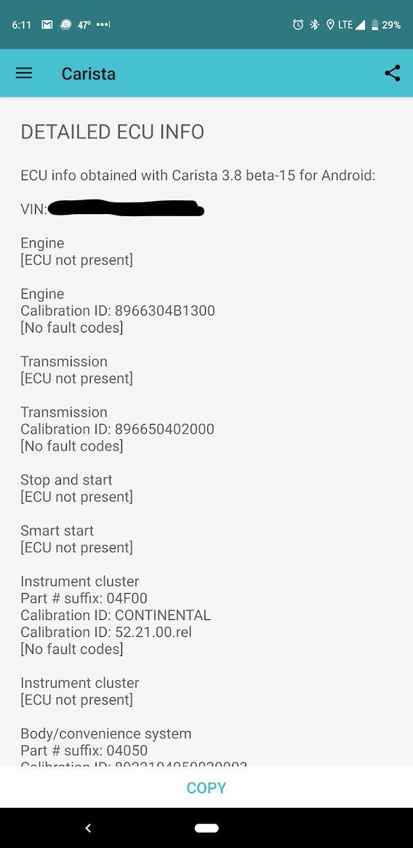

    In other news! I got a Carista beta update:
    The Detailed ECU Info in the Service menu is now showing the Cal ID. :cheers:

    Right on, I'll be sure and check these PIDs again once 1.05 drops. Mat will usually state if something like that is implemented in a particular release. A bunch of us will probably ask if he doesn't lol.
    Lol, I love how it says transmission calibration ID.. say wut?
    tonered[QUOTED] likes this.

    Hahaha! I saw that when I posted it in the Carista thread. It wasn't there in the screen dump from the earlier version. I'm not sure what it is picking up on. I might need to cruise the TSB-0058-18 thread to see what AT IDs are shown to see if it agrees.
