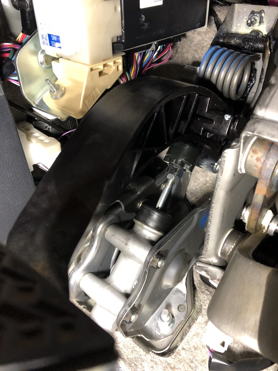

    Do y’all’s clutch pedal assemblies look like this? Not sure if they updated the design but I’m not finding the adjustment points like the service manual details. 2018 TRDOR
    There’s a locknut/adjustment in the middle of the pic but with the locknut backed off the adjustment nut doesn’t budge. I’d assume this is where the rod free play is usually adjusted but I’d like the engagement zone to not be so far away from the floor. Right now as soon as I depress the pedal I can get the clutch to slip.

    With the lock nut loose turn the silver rod with your fingers.
    Make sure you have 2-5mm free play.
    trackdaybro[QUOTED] likes this.

    THANK YOU!! So good now!

    The "locknut" is the silver nut at the bottom correct? Mine does not want to come loose. Right now that whole assembly (silver nut at bottom,larger nut and top piece) rotates prob more than 10mm. When I try to loosen the silver nut the whole thing spins till a certain point and when I put further pressure to loosen the nut it feels like i'm twisting the rod or putting pressure on it in a bad way. To remedy that I put another wench on the nut above the silver one to hold everything in place while i try to loosen and still no dice. Any ideas?

    Righty tighty, lefty loosey?
    You may have jammed the rod in one of the nuts trying to loosen the silver nut without holding the black nut.
    Hold black nut, 14mm and loosen the silver nut, 12mm.

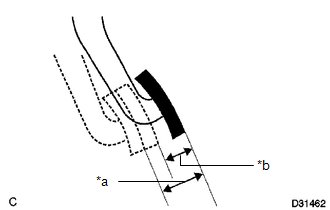

    Is there a way to directly measure free play with the push rod? The manual basically says it’s the “distance from pedal top to when resistance increases” subtracted from “distance from pedal top to when resistance starts”
    I have some metric calipers. Can I just measure push rod length to determine my free play or do I really have to fuck with the pedal and measure from pedal to floor for each of those steps?

    Thank you. I got it done. Love this place.
