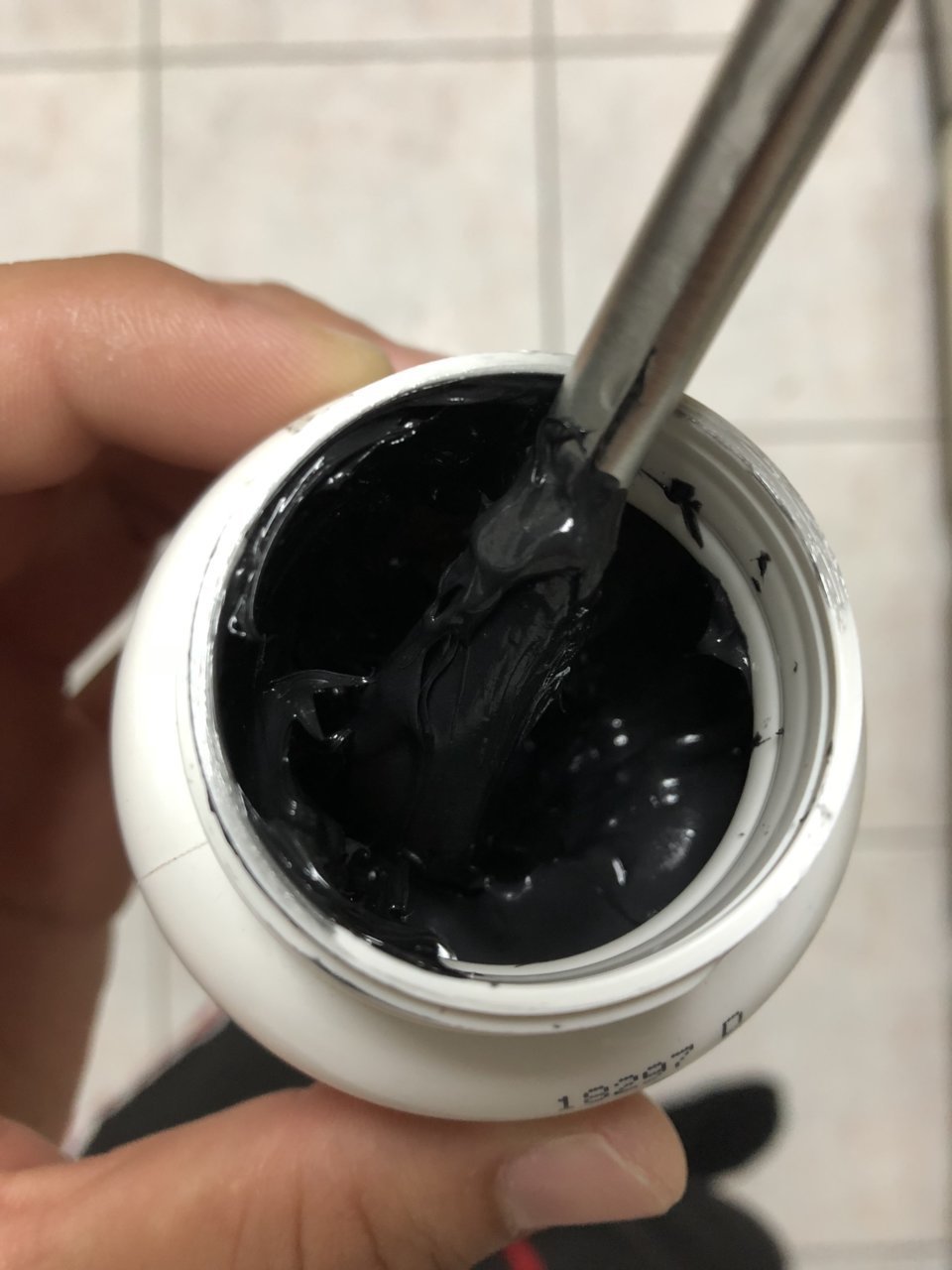

    My dealer wanted to replace the pedal with the same assembly.. and their grease didn’t last. I’ve tried almost all of them and am telling you, skip any grease you’re thinking about and grab a $5 jar of disc brake grease from any auto store. It comes with a brush but is messy, as mentioned above a wooden stick would work, maybe a disposable chopstick?
    Put down a towel, lay on your back on the driver side floor looking up at the pedal assembly. Careful with the stuff, it’s very thick and tacky. Stays where you put it and won’t melt away.
