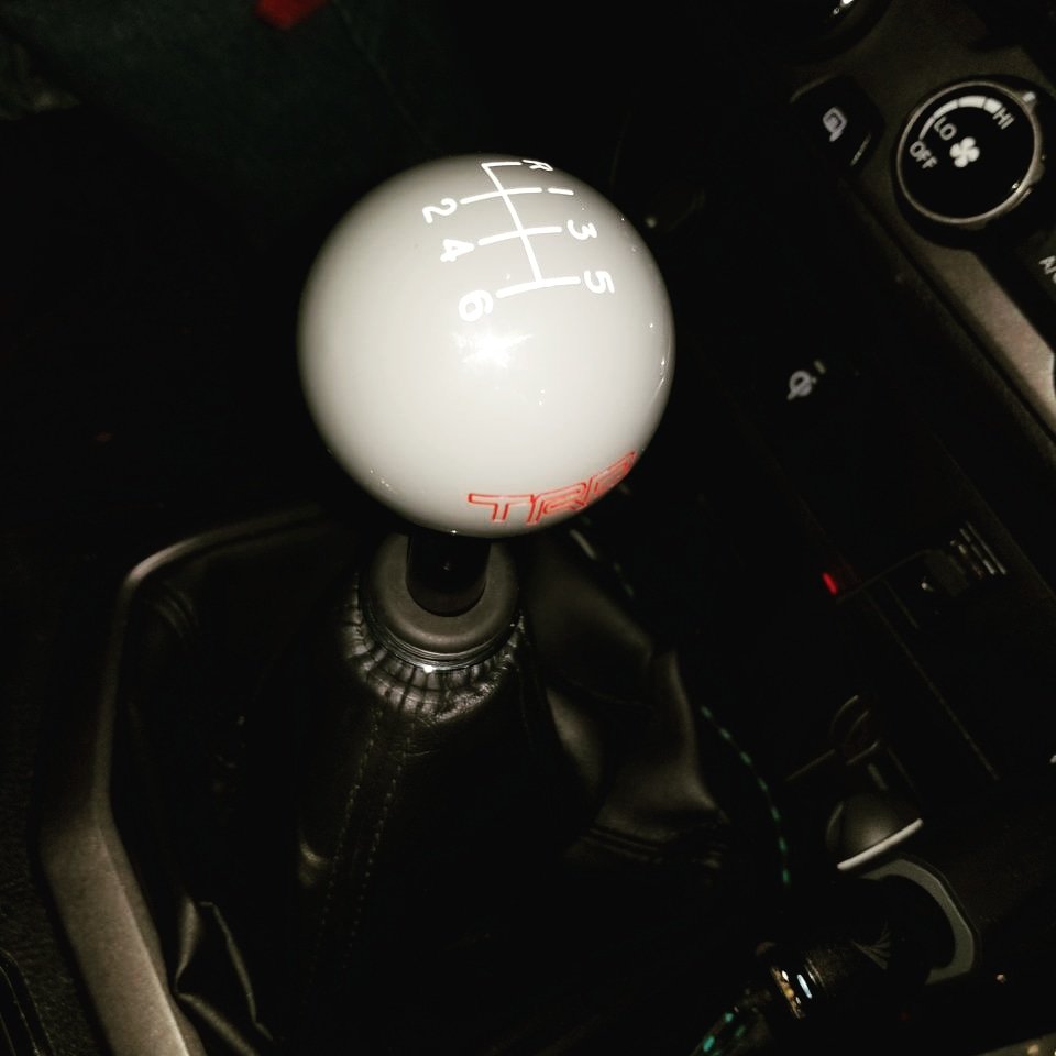

    Stuffed grommet in mine and pushed it as far down as it would allow. I love the shaft exposed rather than having the boot cover it up. @St.Germain

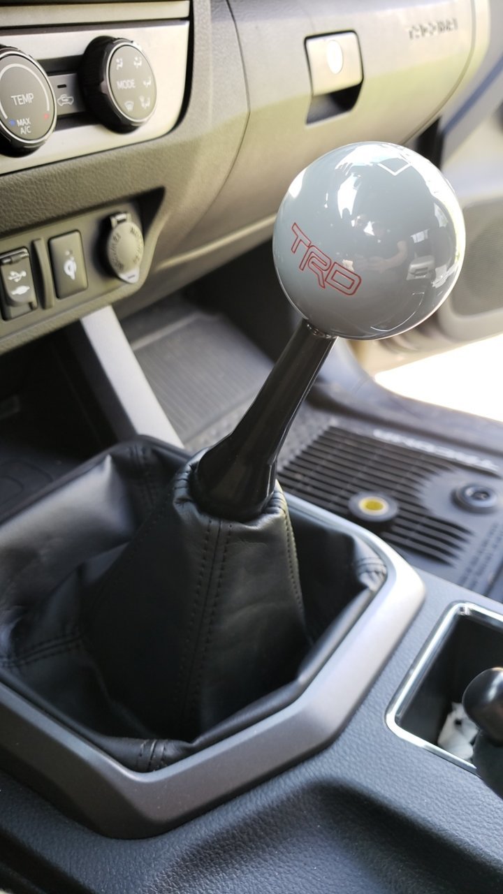

    Give me an hour and I'll take a shot of mine... it's not flush to the knob but it's a Mustang retainer that acts as both retainer and jam nut. Looks super clean IMO.

    @Z2A6X2 This would be my solution. It has a small channel below what you can see so you can ziptie the boot into place like OEM. Super comfortable to wrap your hand around with the ball. Only downside is it's a little higher than OEM so the boot is slightly tight in 6th but it seems ok enough for me.

    What size grommet did you end up using? I will probably go this route. I think I like the shaft exposed a little now that I've been rocking it a few days, makes it feel a little more "truck-ey" lol

    It's a $1 grommet from HD. If you search for "home depot grommet," the PN will come up in many threads including this one.
    One caution is that with the grommet, you will see the shiny chrome of the collar below. I painted mine.

    Got the mixed size pack at harbor Freight tools for like 5 bucks. Honestly forget the size, but it fit like a glove. I want to say it was the 7/8th inch size now that I look at the package. provided

    If I remember correctly, it is the 5/8” inner diameter and 1" outer diameter rubber grommet that works best. Then you cut the lip off one side and should go right in and cover the top.
    Hopefully I got that right, haven't done my own yet. Just got my TRD cueball knob during the 40% off sale and haven't gotten a chance to look at the actual install yet.

    i prefer the look of this compared to the boot being higher or having the chrome collar... any info on how you did it?
