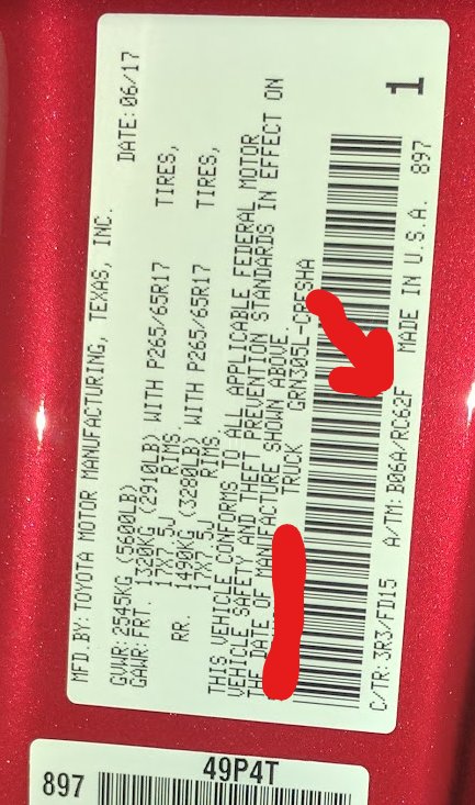

    Thats for the 6 speed, pretty sure the 5 speed was Asin.
