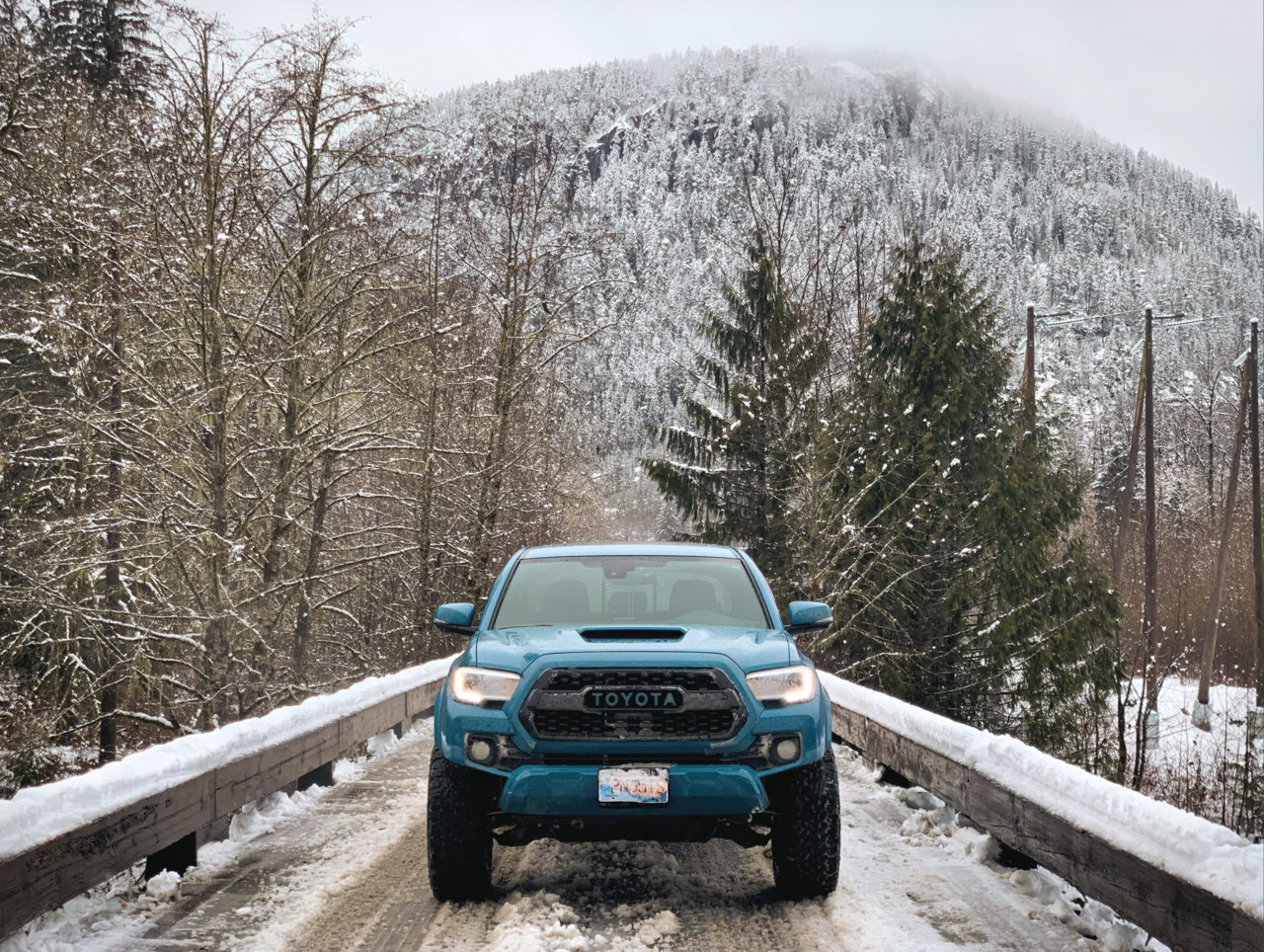

    Still loving mine, not a day goes by that I dread getting a Manual, except maybe driving in sand. Still haven't seen many in Canada in Sport w/ tech package.

    I got sport with premium and tech package with MT.:D
    Edit: that bridge looks very familiar, where is that?
