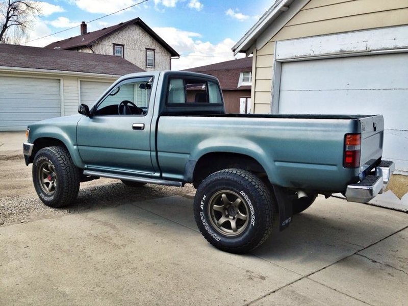

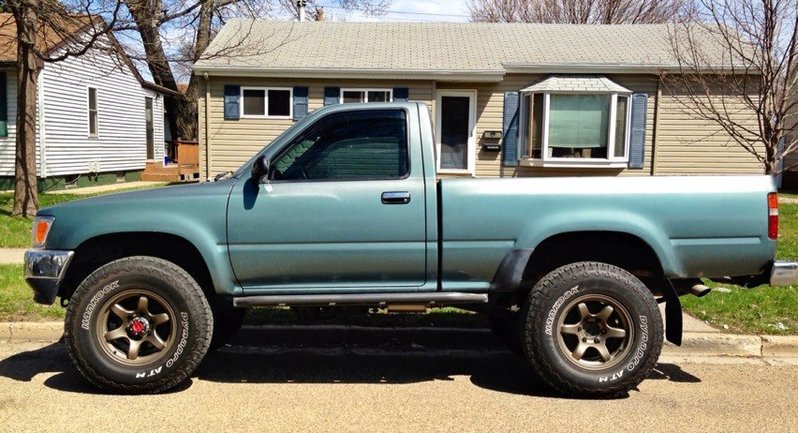

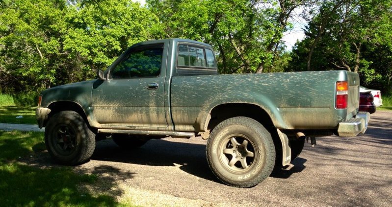

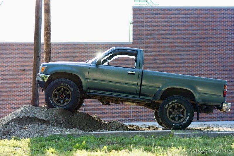

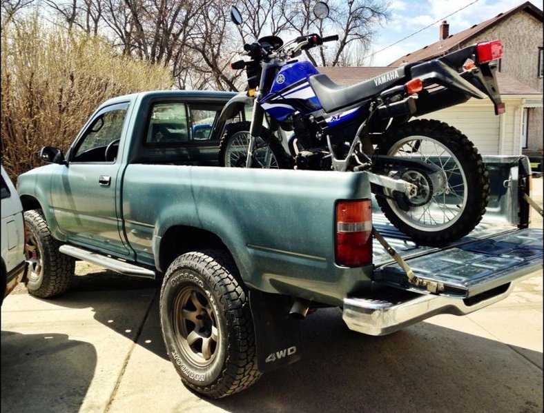

    All gens welcome? What about a pre-Tacoma Pickup? 6546B5B3-D551-40FE-84BD-3444BC69FD4B.jpg

    D271638F-2834-425D-B4C9-4B134CF2F8A7.jpg CAD56340-CD69-479A-8EB0-F149DA4DE550.jpg B19C696E-5C90-4EEB-95F6-8B10A653AC6B.jpg 03CCD673-6B53-4490-BE0C-807E28769B18.jpg EDC7484C-788E-4F1E-964A-72043D69CE91.jpg 875EF390-31D3-4C54-9E8B-44ED5F7430D4.jpg
    Tacoma was also a manual but sold it to my buddy in Alaska after I realized I only ever drove the Pickup anyway.
