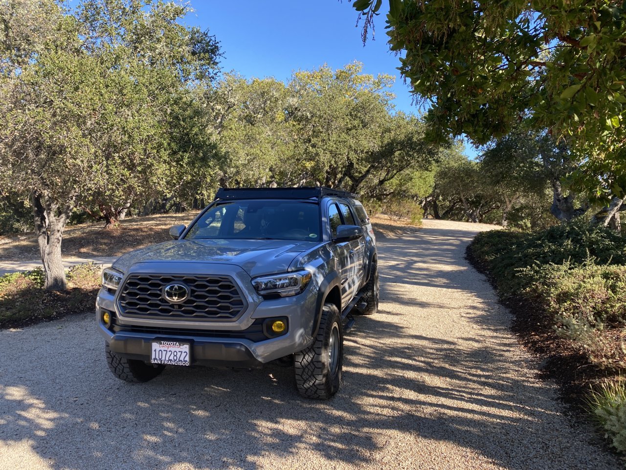

    Here’s my 3 pedal machine. Didn’t know this thread existed until now...
