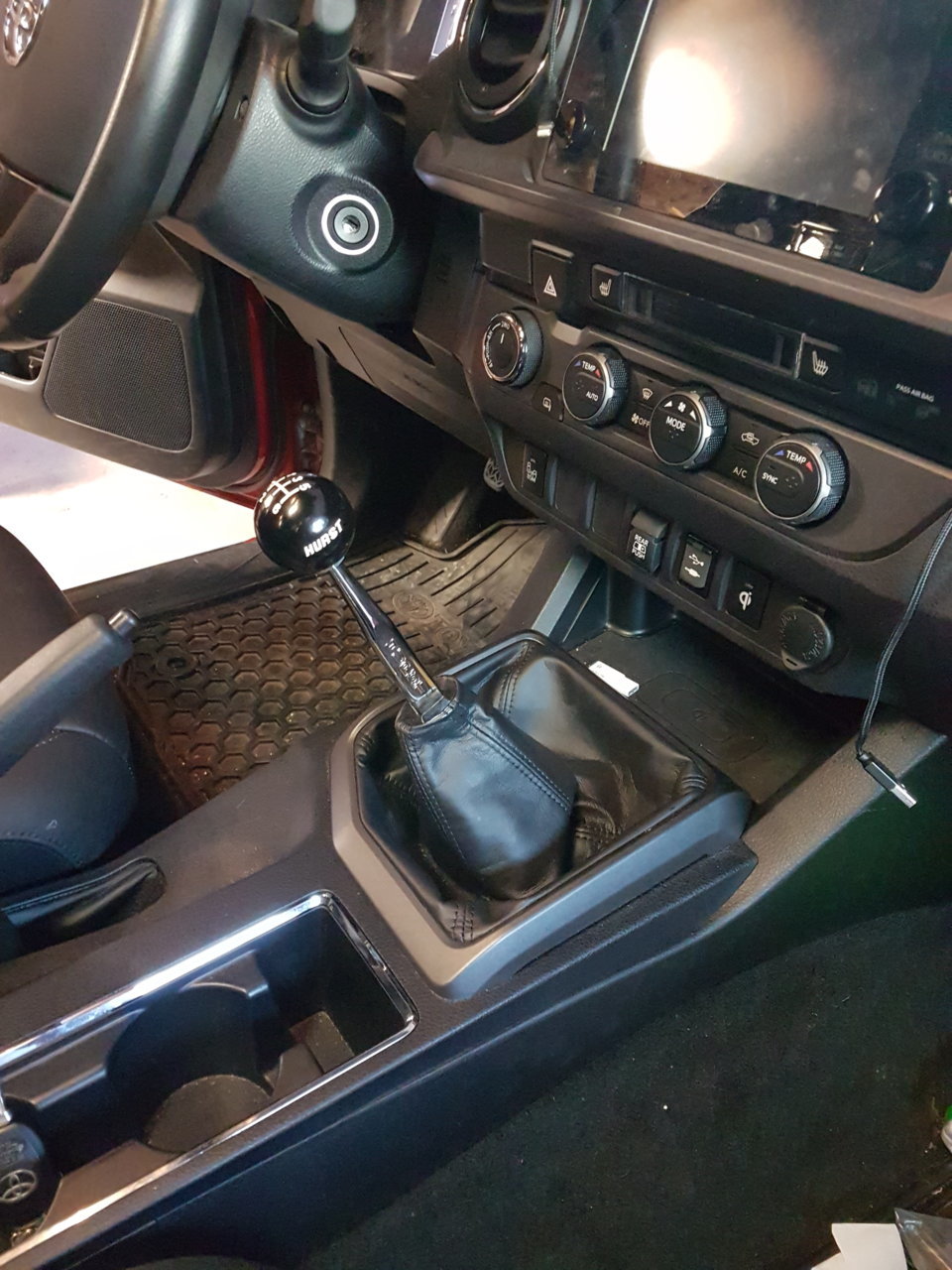

    Question for the mt crew here.
    I have a 2016 double cab. She's heavy... Dual agms, winch, steel bumper, steel skids, sliders, racks, tent, 33s... The whole shebang
    I love my urd stage 2 clutch, but I can feel the weight eating at my clutch, so it's time to spend some money on a regear!
    Now, I come from driving civics and small shit. I love the idea of being able to start on second gear and have that peppy feeling. Obviously my 6500lbs truck won't feel like that, however, I'm strongly leaning to 5.88's. I rarely see 80mph so top speed isn't an issue.
    Anyone have any negatives going to 5.88 in a manual? Thanks!!

    Where did you get that shift boot, is it custom made?

    Niiiiice.
    :101010:
    How do you like the short shifter?
