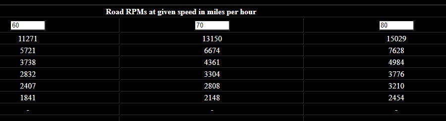

    Stock gears and tires:

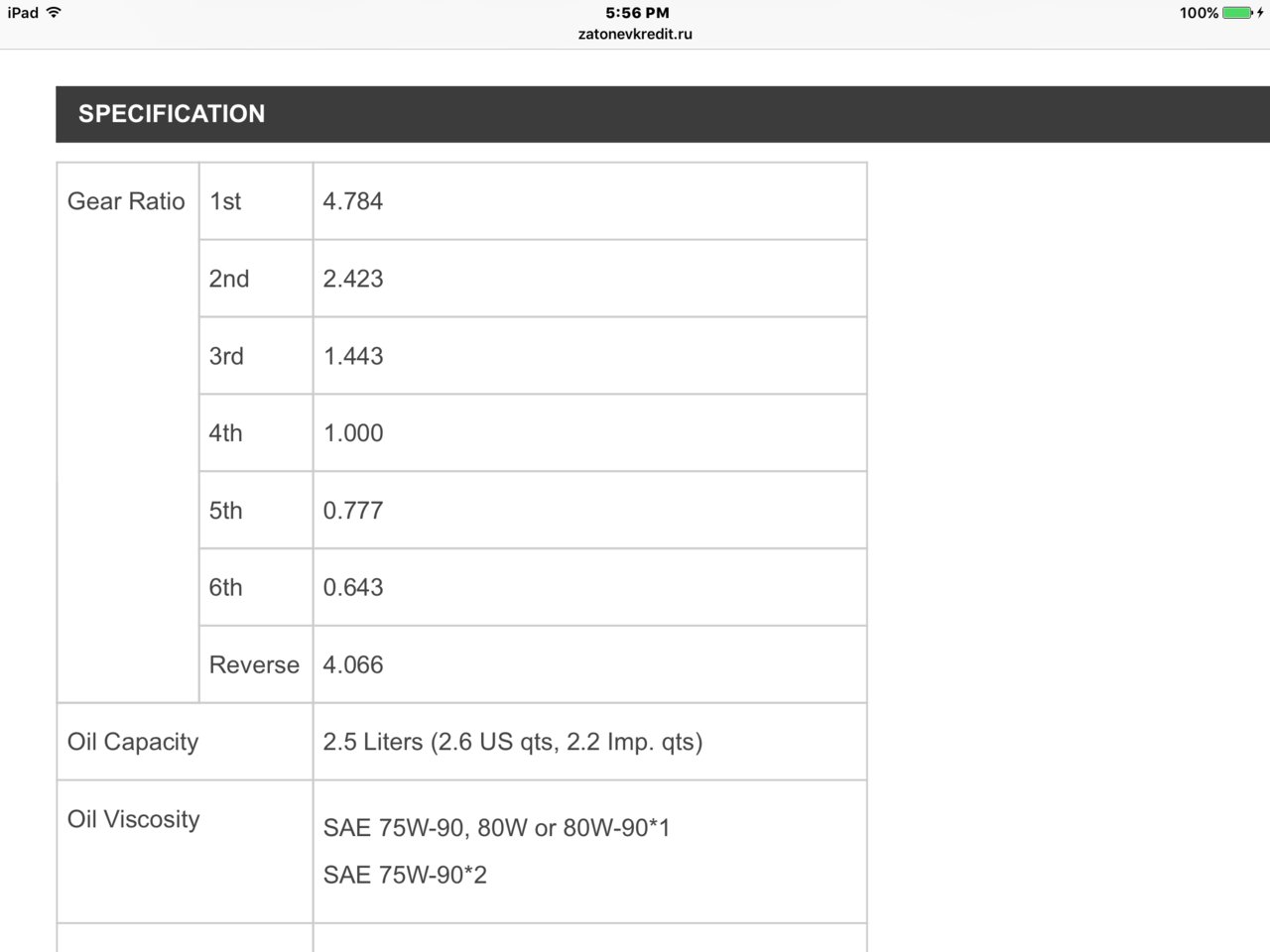

    With MT using the AT gear for 6th at 0.58 it looks like this:

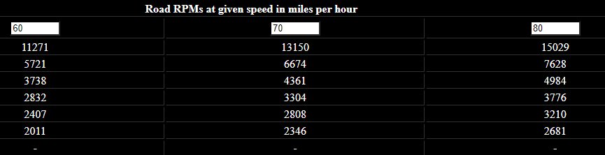

    My point is that at 60 I think 5th is the proper gear and at 70+ I'd want a real 6th. I do think 0.58 is pretty lean, subbing in my guess of 0.65 gives us:
    And that's right where I think it'd be best. So if you're cruising at 60 and going 5th to 6th, instead of an anemic 396 rpm drop with stock from 5th to 6th you get a legit 566 rpm drop. Then when cruising at 80 you're closer to the AT rpms as well.

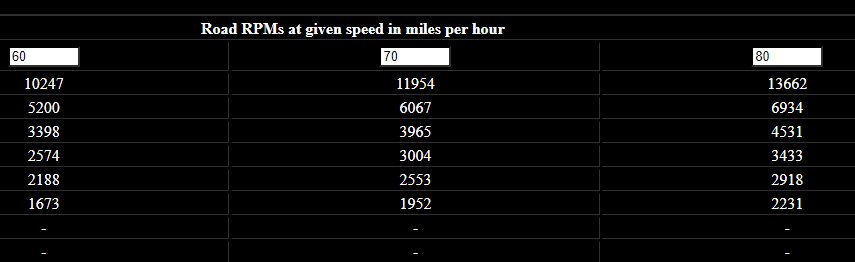

    EDIT: Think I fixed the numbers, getting the AT versions too now.
    Yeah, so looking that over, AT is just stupid at 3.909, 6th is pathetic and barely usable until 75+. Somewhere in between is that sweet spot, at 70 I'd want an option to be right around 2200 rpm for max fuel economy with just enough power to accelerate reasonably if needed.
