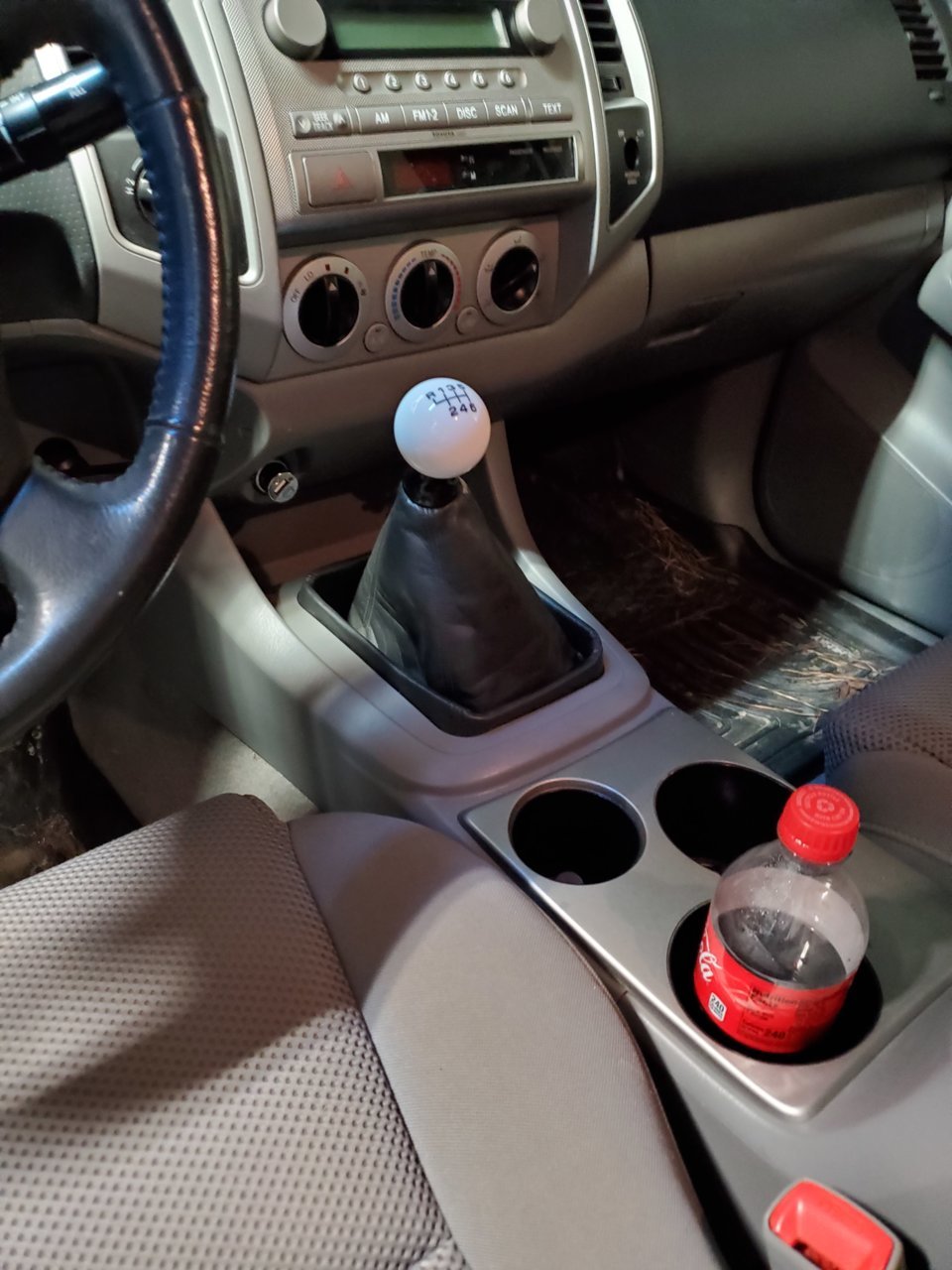

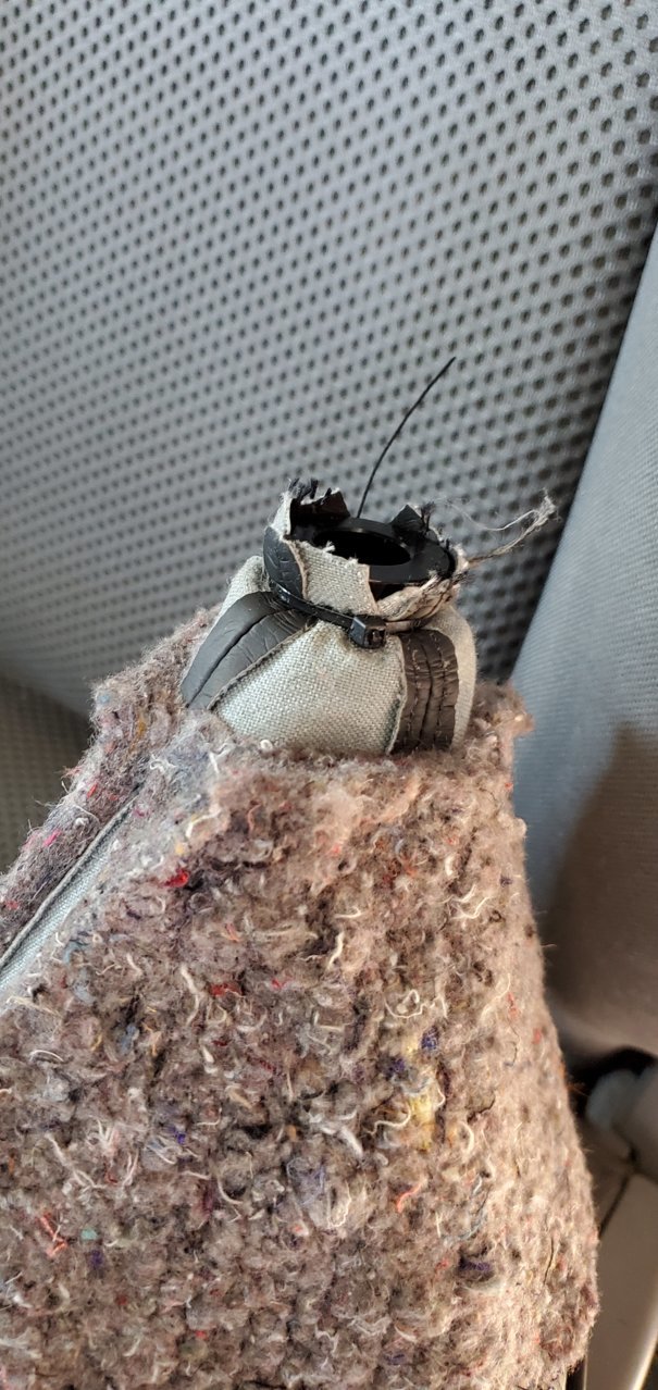

    Yep. I flipped my boot inside out and used some leather thread through the top loop of the boot then zip tie for good measure. Then threaded the adapter onto the shift rod before flipping the boot right side out. Then just work it through the console and snap into place.
    I ended up making a few minor adjustments with it in place to get my shift knob to be tight in the right orientation. Once everything is tight you should be able to straighten the boot still

    Got any pics?

    So. Many. Stickers.
    So what does it do? Just tighten and tidy everything up?

    Keeps the shift boot tight to an aftermarket shift knob. That you don't get that ugly gap between the shifter and the boot you see with most aftermarket knobs

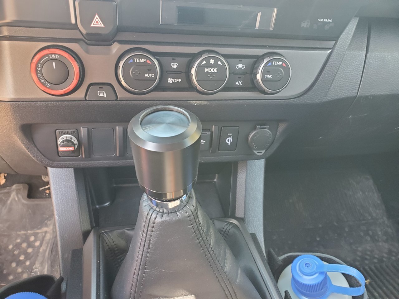

    Well, put a 460 gram shift knob on. It certainly makes shifting feel smoother.
    I forgot to change the address when I ordered the shift boot retainer though, so it is now thousnds of miles away with my wife.
