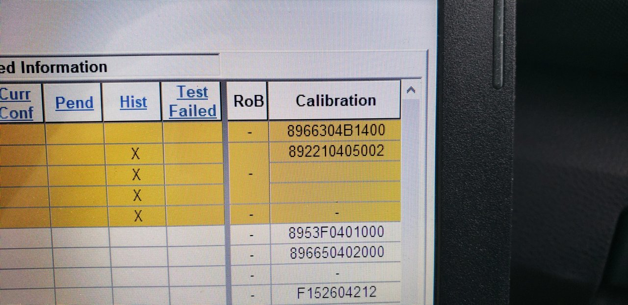

    It is done...
    now the ADM.

    Yeah! While you're in there, do the Learned Value Reset. See the 1st Post of the ECU Update thread.

    I have to admit that I was not sure about the a recal. I do them regularly at work on Diesel's and they are just about changing the threshold of codes triggering. Less sensitive code triggers means less driver's park vehicles because the CEL is on and less maintenance requirements.
    So now that I have driven my truck with the new recal, for a almost a week, I feel I can safely say that this recal is nothing like what I have experienced before. To start off with, right after I did the recal and reset of learned values I drove the truck to pick up my daughter from school. Not far from my place I had to stop at a red light on a fairly steep hill. When I released the clutch to start again I was surprised I had zero throttle. The clutch was all the way out, the truck was in first gear, it felt like I had it in 5th. I was concerned.
    After this the truck was fine... better than fine. I started to notice how much smoother the throttle response was during shifting. And the seemless transition from light throttle to coast and back again. The engine responds better on initial clutch engagement at a stop. No more slight stumble. Even when cold it is greatly improved.
    I had the rematch with that hill this morning... the one that caused concern. This morning the engine was smoooooottthhhhhhh like butter.
    This raises 2 questions with me... why did I wait so long? And what would a tune do if this recal did such a great job?

    Sorry about the Reset fun. Doing them on 04B14 Stock was the oddest that I felt. The first time that you goose it, it can be odd.
    The comments made about 04B14 and 04B33 (the most adopted of the newer ECU IDs) are all like that. Trust the horde! Hahaha!
    For the vF Tunes? Add a similar amount of great changes and say bye to clutch slip in 1st.
