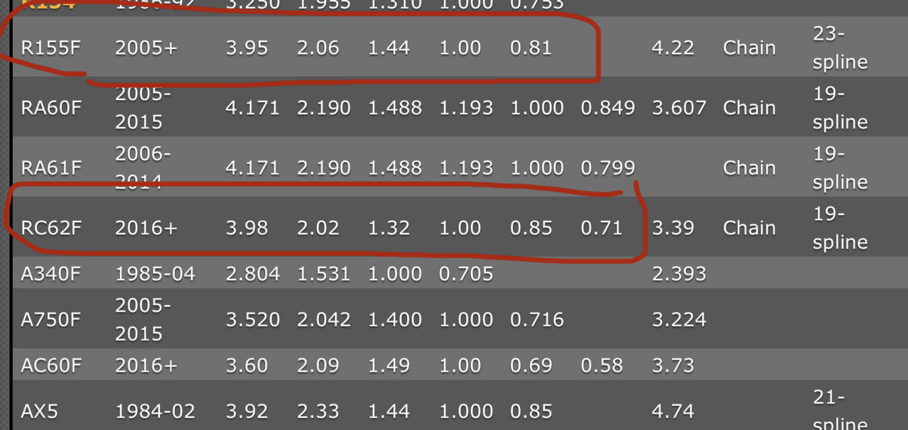

    Gear ratios. 4th gear is 1:1 in both transmissions. 5th in both are similar ratios. 6th in the V6 transmission is an additional overdrive, which I personally wish was a bigger jump. I think the thought process was the I4 wouldn’t have the power to pull the additional OD?
    If you look at the AC60F below, it’s pretty clear why the autos like to hit 4th gear with any incline. Both 5th and 6th are extremely tall gears

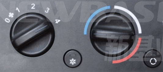

    All you manual climate control guys, go replace your home thermostat with this if you love it so much :rofl:
