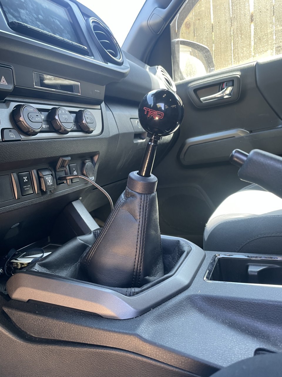

    I like both, just liked the black better so made an effort to go after it as I thought the dark look fit my darkish interior better. Both look good though and functionally they are the same!
