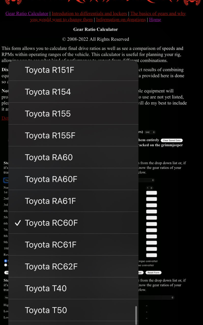

    Just wanted to share with all of you that I messaged the fella that runs the grimmjeeper.com gear/rpm calculator and got him to add the RC60F, RC61F, RC62F. :cool:
    It’s easy enough to memorize the ratios and type them in, but at least now all we have to do is scroll (kind of a lot of scrolling since we’re in the T’s!)
    also had him add the automatic (AC760E/F) but that don’t pertain to us manual folk.

    So that covers hilux, 6MT and 5MT? I thought hilux was RA something?

    Covers the Hilux (60), the 61 (I forgot what that comes in but it’s mentioned in the RC60F thread), and the 3rd gen 6MT (62)
    the 60 & 61 are very similar and have all the same ratios except 5th, but I figured why not request him to enter both while he’s at it.
    the 5MT is the R155
    the RA60(F) and RA61(F) are 2nd gen Taco and FJ 6MTs as far as I’m aware. The R155, RA60 and RA61 are all in the calculator already.
