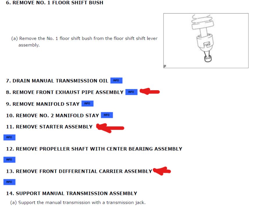

    That's that one that I watched (no sound) also and was pretty pleased. I suppose that I wouldn't disconnect the shafts at the diffs, but it is a lot less work than the SM sez:
    Starter and front diff??

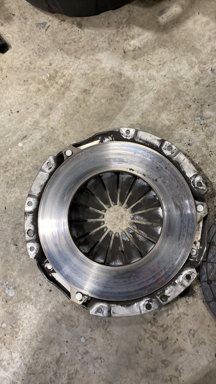

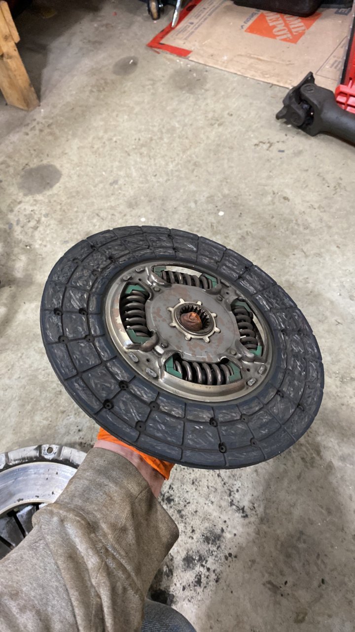

    Well, the chirping can last another 50K or 5K, no certain number. You will know when it goes... The last time it blew up on my truck at roughly 75K miles. I was on 35s and stock gears.It damaged the input shaft and bent the fork slightly, this time I changed it sooner, but the flywheel was long gone, and I had to get another one, was very lucky local club member donated one to me at no cost. :bowdown:
    Still had another 50K lol, maybe... the main reason to drop and change it all was the famous noise and the last experience where things blew up after the noise and I had 7 neutrals and large bill for the extra parts. :anonymous:
    2028CC22-A761-42C5-8A74-5F46D0819437.jpg 56A41D55-0CA7-43A2-B37F-94FE28DD8909.jpg

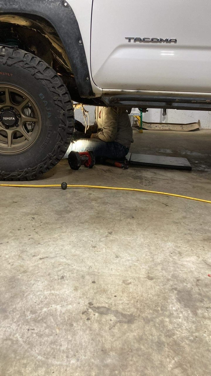

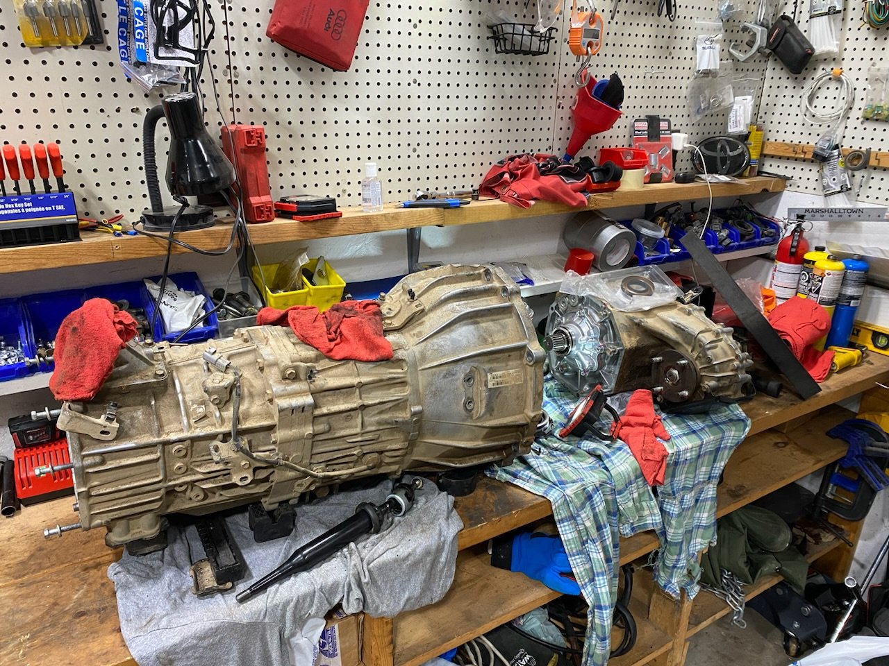

    Don’t need to touch the starter or the diff, just finished doing the clutch. Which is the third one on this truck in 103K miles...:bananadead:I am on 37s and stock gears now and beat the crap out of this thing since it's my weeekend toy:rasta:. The only special tool you need is a 5ft extension for the top 17mm bellhousing bolts.
    It goes very simple if you have exhaust reroute done:
    Remove driveshafts
    Pop the shifter from the cabin
    Lift the cabin around 1.5" up using 2x4s
    Remove cross member
    Remove all the 14 and 17mm bolts around
    Drop the whole assembly down
    Do the clutch and rear main seal
    Put it all back, you can remove the transfer case and install it after if wiggling the entire thing isn't your thing :p
    while at it, extended the breathers for tranny and t-case (should be 3 lines in total, 2 for t-case and 1 for tranny).
    This job fucking sucked! But next time it'll go easy, I hope :annoyed:

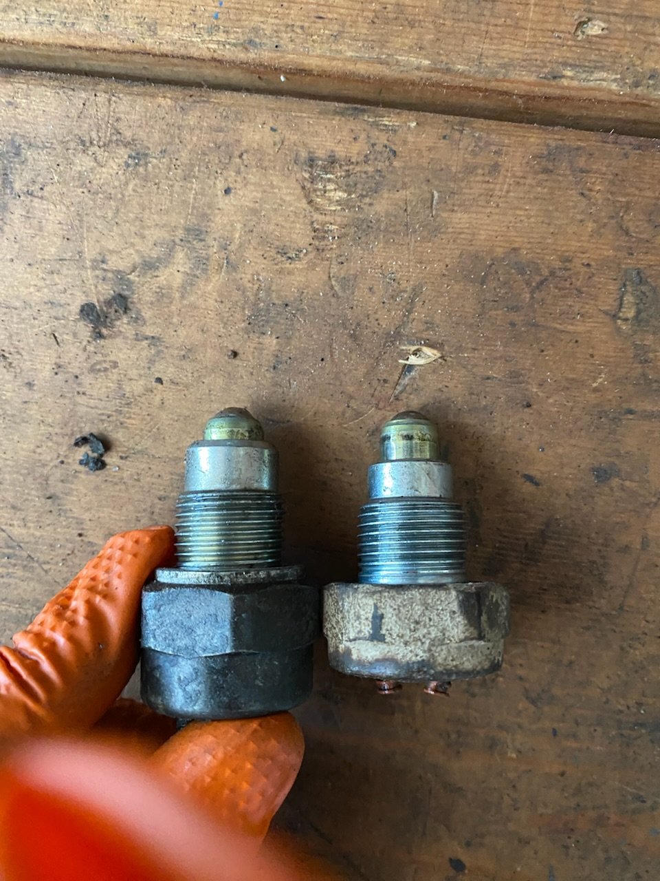

    Oh yeah, fun fact, the reverse sensor wiring got damaged while re-installing it all back. So here goes the spare fj case that I have for my future manual swap to save the day! The sensors are interchangeable if anyone ever gets’s a similar problem.
    The entire job was done like this, so yeah, this was fun!
