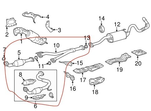

    I got over the denial stage and am ordering up parts now. I don't have the reroute and saw the right cat to Y pipe gasket is $50. WTF? The left one is a reasonable $15. So, I am wondering: Can I get the two mid-pipes with the rear cats out while still joined to the Y pipe?
    If so, that would be killer.
    Thanks!

    Is this what you plan on taking out?
    you can, it’ll be just heavy, why not just to reuse the exhaust gaskets?

    Perfect. Thanks!
    Weight is NBD.
    I've heard that the crush-type gaskets can leak if reused. Of course, that might be more of an issue with aftermarket stuff. I don't mind the upstream gaskets, just that senseless $50 one. Haha!

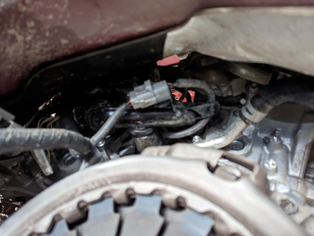

    Here is my report.
    Started at about 9a and finished just after 5p. I was only able to sneak in about four beers because it was all hustle.
    @Norilsk . I get what you were saying about the breathers and completely misunderstood at the time. I thought the breathers under the hood were a combo of the gear box, T case, and front axle. I spent too much time disconnecting the gearbox breathers before pulling it only to find what you were talking about. Kinda weird. But, I had no time or will power to do anything about it at that point. They can be seen at the back of the bell housing in the 1st pic below.

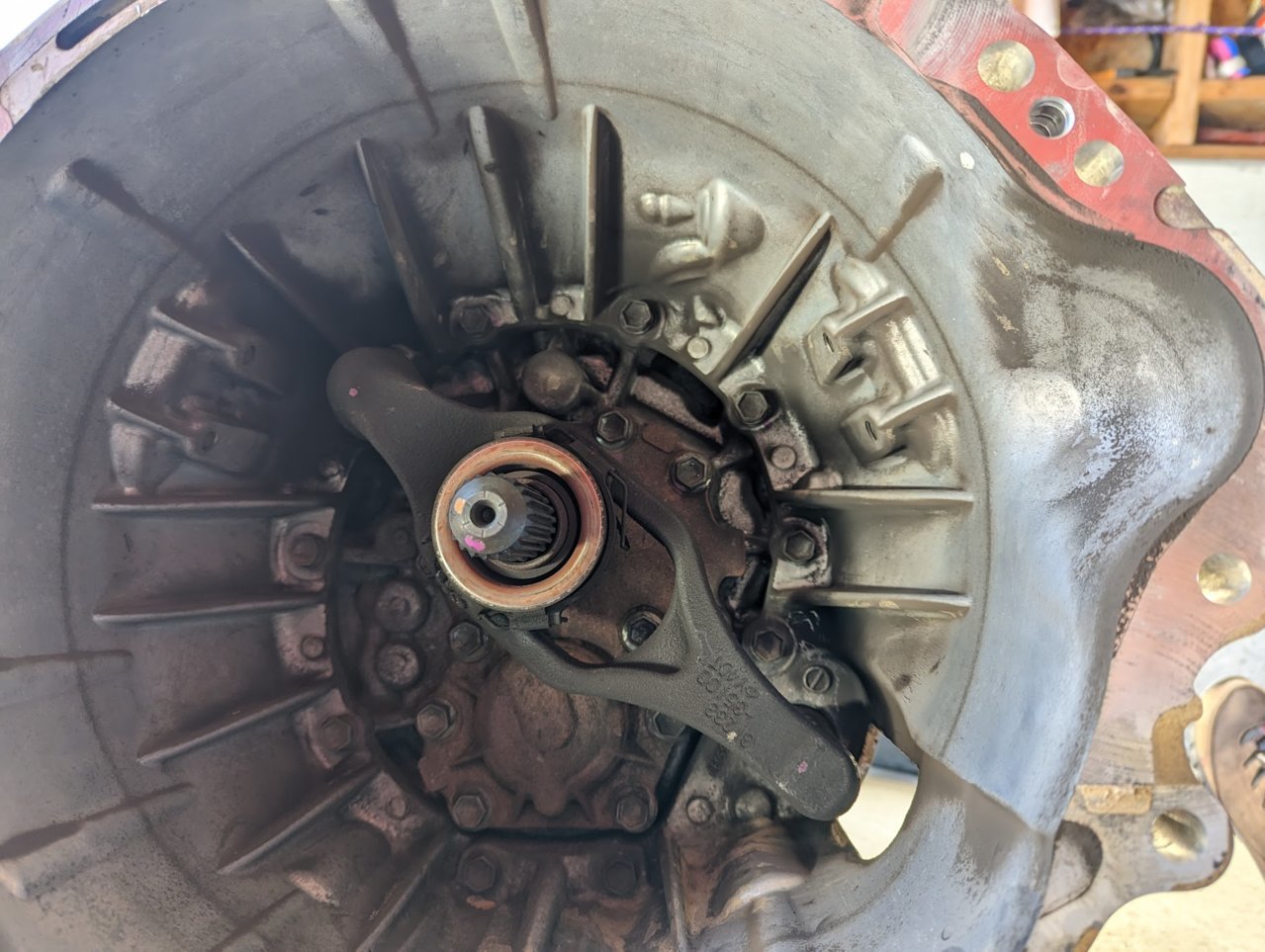

    The TOB coming out didn't seem ruined, so I'm going to save it to swap in later. :rofl::rofl:
    Nah! I intend to pull it apart and see the condition of the actual bearing.
    Took about 4hrs to get the MT out and it felt like it took no time to get it back in. Although the different length 14mm bolts threw me the fuck off. Probably lost an hour trying to figure out why the short ones were not catching the threads and the 17mm bolt wouldn't 'align' in the holes. A friend arrived for the installation and we both thought that somehow the thing was clocked a bit. Too damn funny. Yeah. There are guide pins between the engine and bell housing. Just some cornfusion.
    That was the only hitch other than a bit of air in the clutch when done.
    You can definitely slip out the cats and Y pipe together to save a lot of dosh on new gaskets.

    Sorry, but no clutch pic. It came out framed in on the suspension. LoL!
    I think the rust on that plate is sort conclusive that the TOB saw some water at some point:
