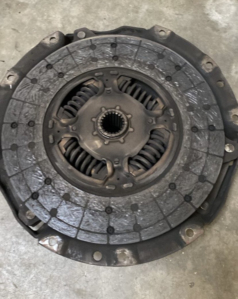

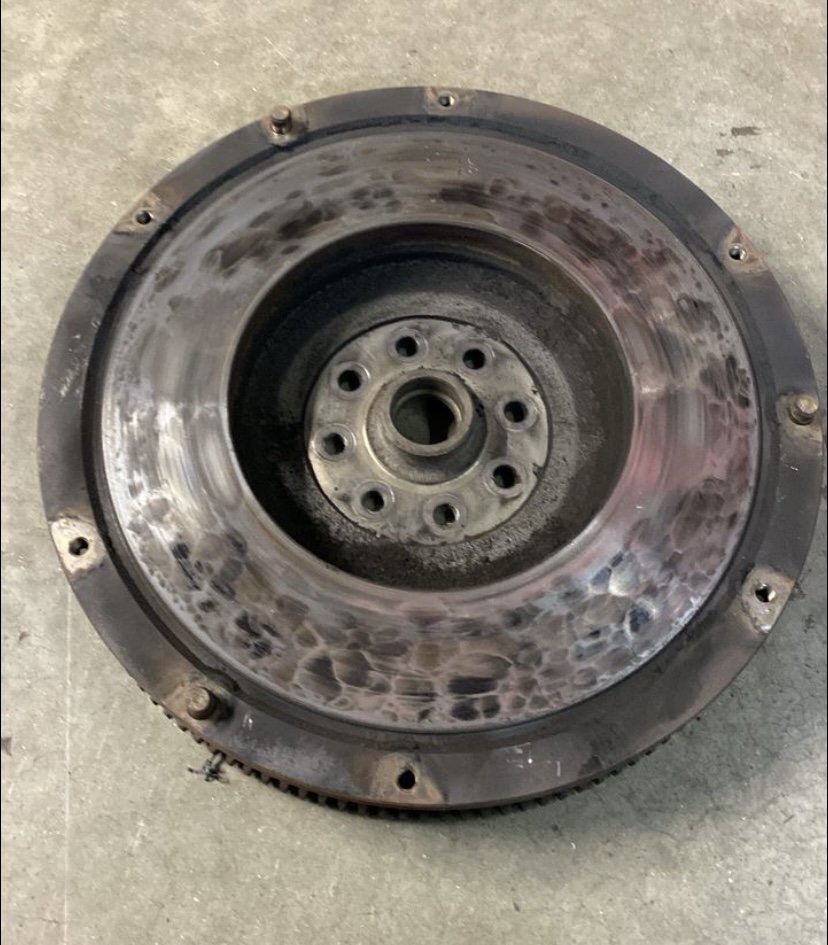

    Just sharing what was just replaced!
    26F622FE-9482-49C2-BC24-4EF3F1B7A3BF.jpg 3E83F551-B716-443E-9ECE-511A7F5B723E.jpg

    How many miles on it?
