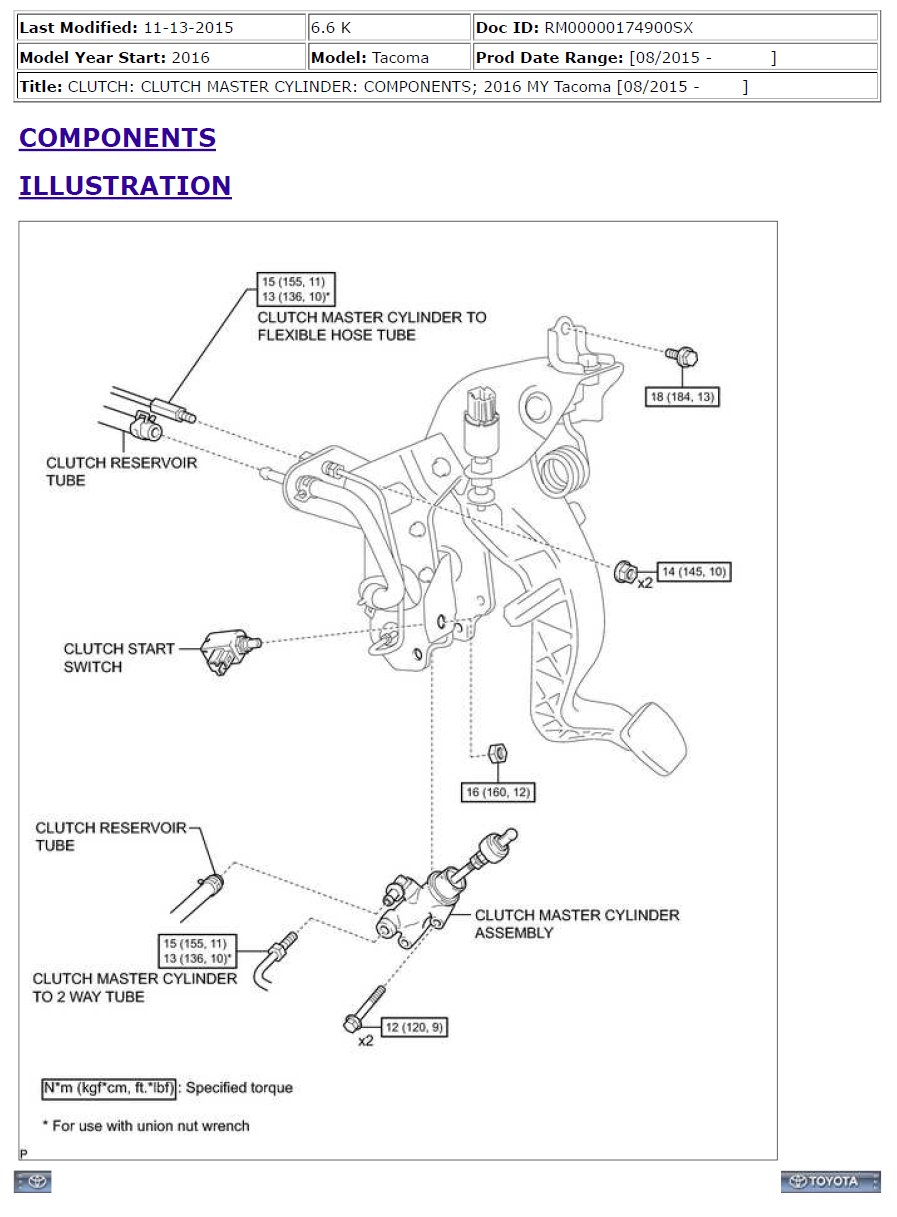

    For my '05 Tacoma, I swapped OEM all weather mats for weathertech b/c they have much better coverage to contain water (and in the PNW it rains a lot). The clutch already required strong force to start the truck but now it requires a fairly significant effort to push the pedal and smash the floor mat to get it to start. I'm guessing there is an adjustment to the point of engagement of the switch controlling the engine cutoff? I installed cruise control after buying it so I know that switch isn't involved in the starter cutoff, it would be a different one somewhere else. Anyone happen to know anything relevant on this one? I am guessing an '05 2nd gen might be different from 3rd gen setups, my 3rd gen of course has clutch start cancel so I can start it while standing outside (keeps the wet shoes from messing up the floor mats when starting on a cold morning). And, yeah, remote start is another option but I don't feel comfortable with that right now given my kids age and our steep driveway.

    Usually clutch start and cruise control equipped trucks have two switches: one at the top of the pedal when you press the pedal at all, it immediately cancels cruise. The other is at the bottom of the travel and gets pushed when you’re all the way to the floor. Both are usually threaded and locked in place with a jam nut for adjustment. You could likely thread the one at the bottom out towards the pedal a few threads to make the pedal engage it easier. Basically unplug, loosen jam nut, spin a few times, lock the jam nut, plug back in.
    obviously make sure you don’t thread it so far that the pedal goes crashing into the sensor when you push the pedal down.

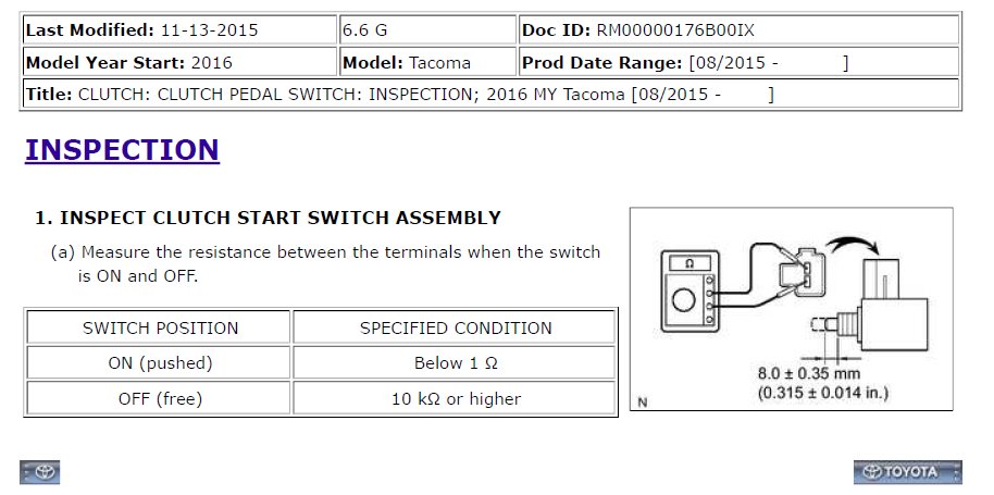

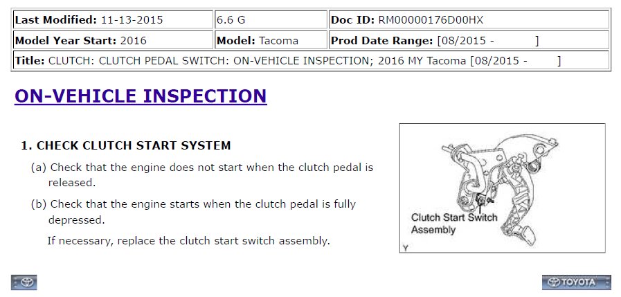

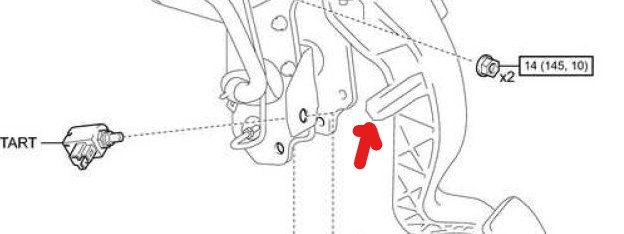

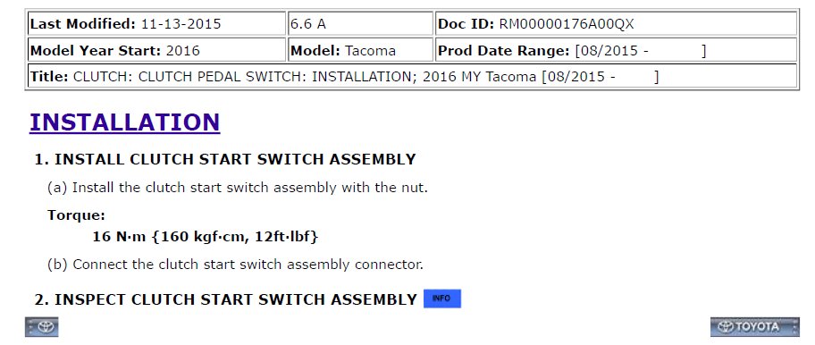

    I think you would be looking to adjust the Clutch Start Switch. The other switch at the top of the travel is grayed out.

    Cool, yeah, makes sense, I'll hunt for that sucker. So it's not terrible to adjust it a bit, as long as I don't incur damage to the sensor itself? It's up high perhaps? Whereas the cruise jam nut was at the top of the kick panel.

    If the switch is not adjustable, you might be able to add some adhesive backed material to pad on the pedal?
