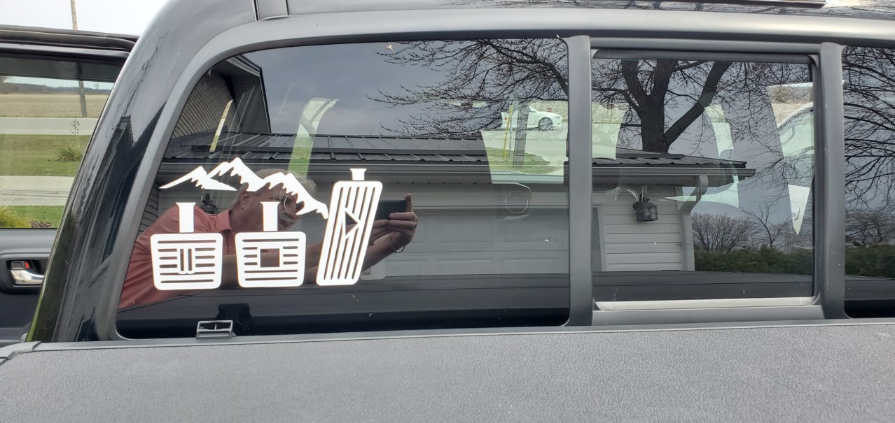

    I do stickers typically on the left side to not block visibility. But, that doesn't really matter with the Taco.
    CygnusX191 and TeecoTaco[QUOTED] like this.

    :thumbsup: Nice!
