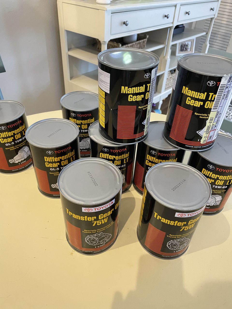

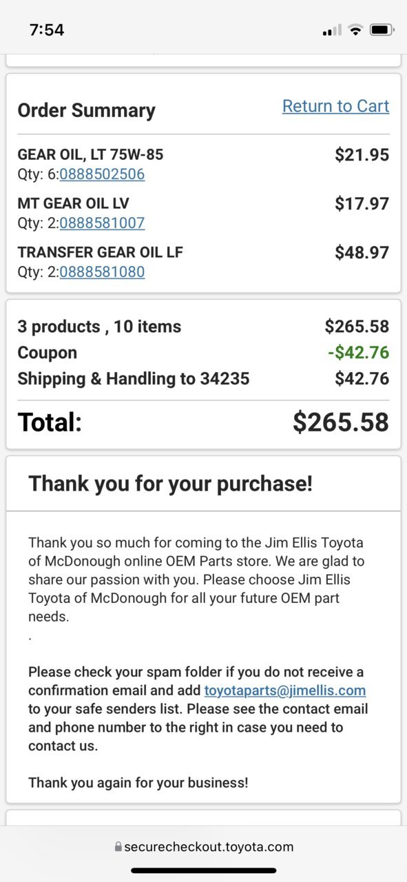

    I use all oem fluids. Wait until there’s a 25% off sale and free shipping and you’ll get a decent deal on them. I use Jim Ellis Toyota online parts store.

    Wow ! Thanks for the link - I appreciate it - didn't see OEM when I was searching .
