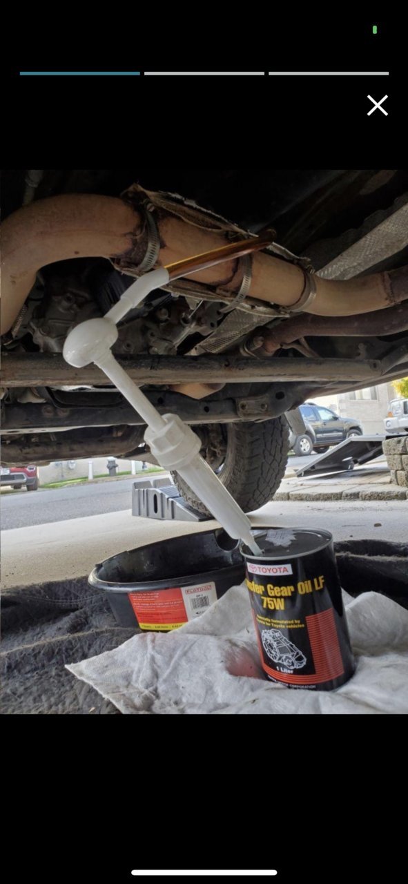

    I think his question was in reference to the Toyota fluids being in the old style metal topped flat cans. These, traditionally used a push in spout and are not going to work for direct dispensing since you can't "pour" the fluid into a manual transmission on a Tacoma. We know it has to be pumped or squeezed. How do you do it from one of those cans?

    I use the pump I referenced. Like this, or you can buy an empty quart container and pour the Toyota fluid into it and use the pump I referenced on that. Either way it works.

    What do you have clamped to your exhaust in the picture and why ? Thanks
