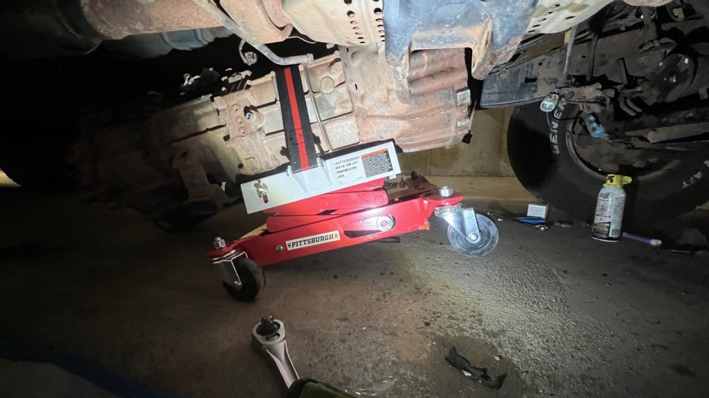

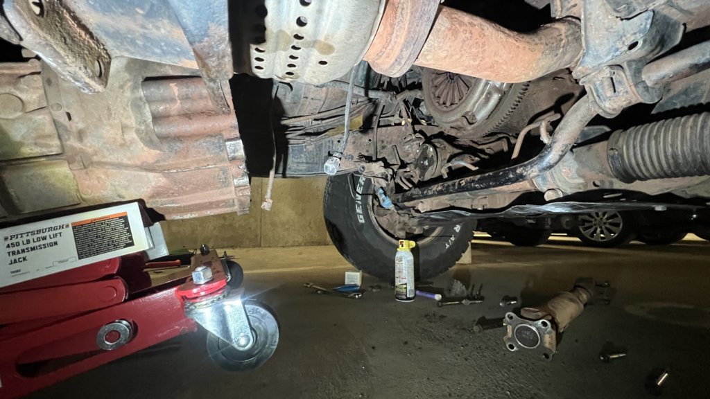

    Long story short. Picked up 450lb trans jack from habor.

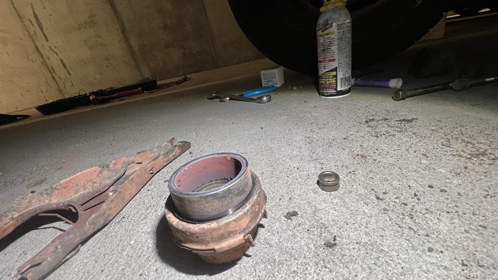

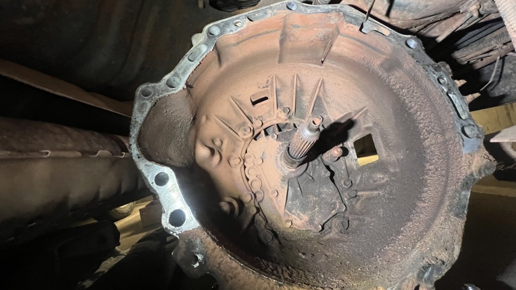

    It came out not too bad. Pilot beard race was laying on the fingers of the pressure plate. No ball bearings in sight. Not even one.
    Accidentally placed the jack too far forwards and it was tipping the whole time, still got it though.
    Race on fingers
    Race on right and welded solid throw out bearing left
    Tried the socket trick to try and get the outer bearing race out of the flywheel. Not even close. Pry bar didnt work.
