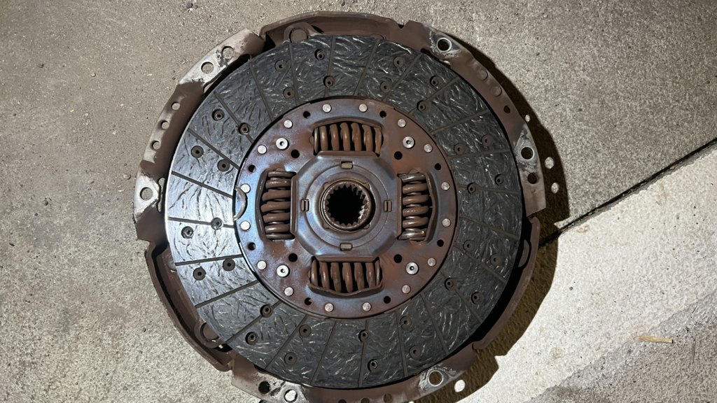

    So clutch, pressure plate and flywheel are still new, even the pressure plate and flywheel still have the machining grooves.
    From what ive been reading youre supposed to install the clutch plate backwards, fat side towards the flywheel. Mine was wrong, fat side towards the trans. Possibly why it failed and possibly why my throw out bearing was always running, since I bought the truck, always thought that was weird. Also wondered why my clutch would only disengage on the very floor, even if the floor mat got under the clutch pedal it wouldnt disengage.
    Skinny side up towards flywheel
    Markings on pressure plate say 2019 and the part number is a autozone duralast clutch. Shame it was installed wrong. Probably would of went a really long time. I have 100-120k on it and its still like new. Although the throw out bearing and pilot are probably garbage.
    Sucks im going to put a new clutch in when this is still new.

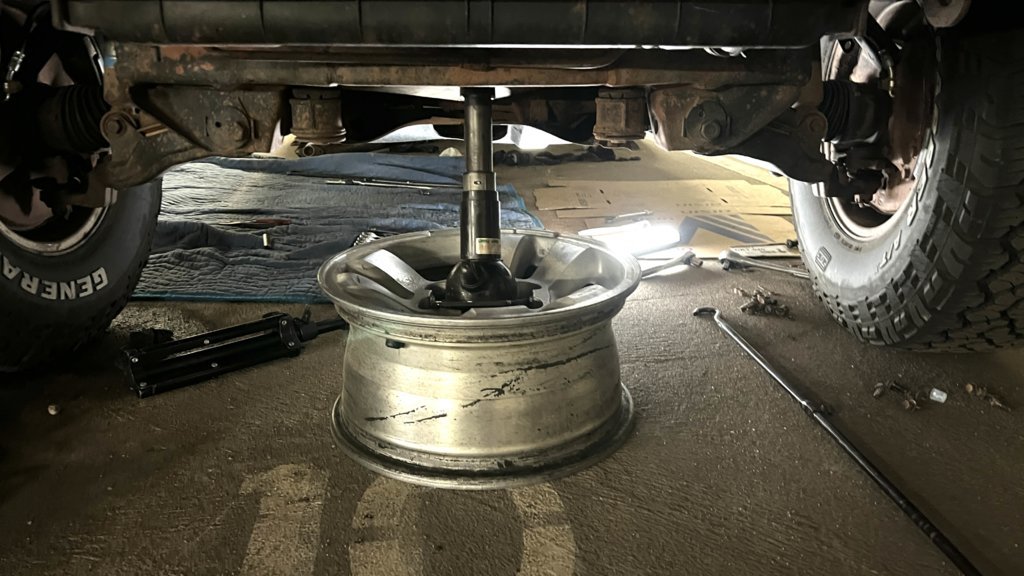

    Thank you. Got it. Back up and running.
  5. May 23, 2025 at 7:07 PM
    #25
    taco2uesday
    taco2uesday [OP] Well-Known Member
    Jun 18, 2020
    #331856
    774
    1999 Tacoma SR5 TRD 5 Speed
    Map Lights, Grey Wire Mod,
    I ended up jacking the front like you said. Wood under the front of the oil pan. It def helped. Thanks
