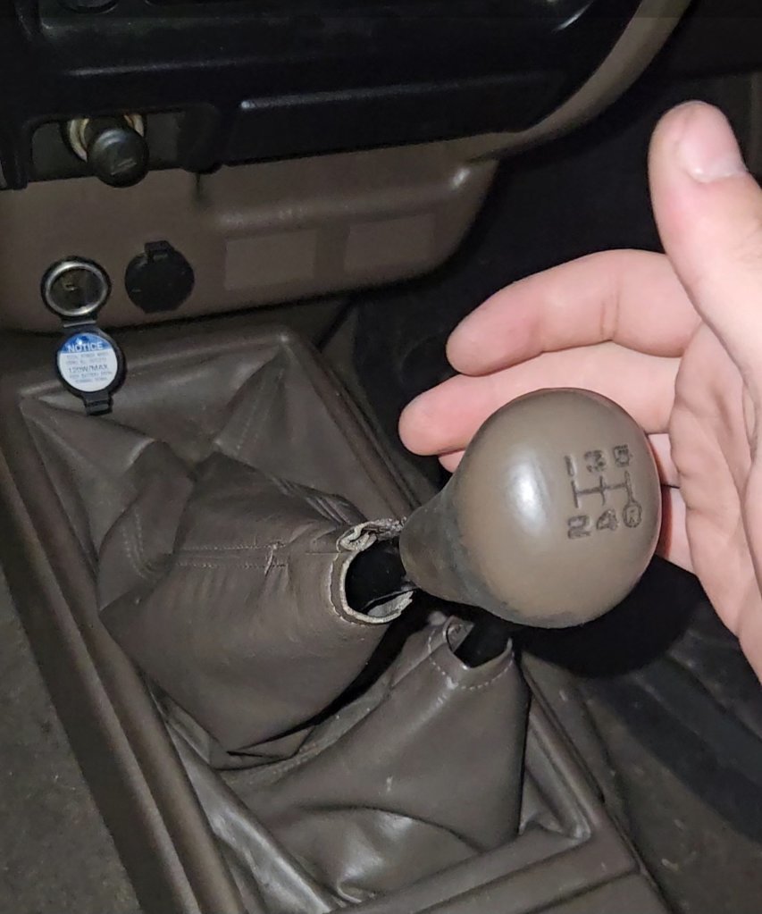

    Every gear is annoying to shift into, mostly 1st, 2nd, and especially reverse. While driving you have to carefully guide it into gear sometimes. It's been like this since I bought it 20,000 miles ago. The odometer reads 535,000 miles and the mileage on the trans is unknown...
    I thought replacing my shifter bushing and clutch fluid would fix it but was not impressed with the test drive and now I think it's the clutch forks.
    I'm not afraid to rip apart the transmission if needed. I've rebuilt one before but I would rather only need to do it out of necessity since I need this ride for work and school.
    Since this problem has been going on for a while, I think I have a lot of time but it will get worse of course. My plan is to find a replacement transmission, rebuild if needed, and swap it into my truck. (probably in the spring)
