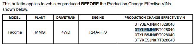

    Damn, my VIN is before the change.

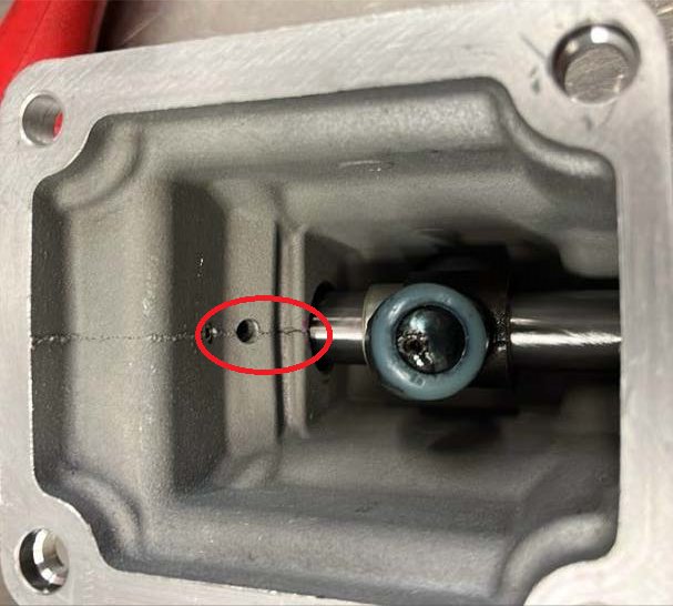

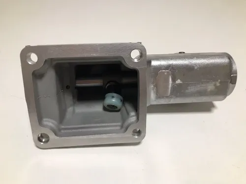

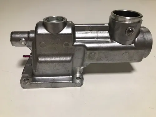

    My assumption is that this is a process issue. If you compare the housings in the pictures I posted, the first two are Hilux housings and the third is 2024 Tacoma. You can see a much larger separation/witness line on the Tacoma housing. That may or may not mean much, but with the part number staying the same, it seems unlikely that a design change was made, but rather that a process concern was corrected so the original design will function as intended.
    Jeff

    The production date of the VIN in question is June 6, 2024. There's a good chance the number of 2024 Tacoma 6MTs post-change is few to none at this point.

    That's the date I drove off the lot. It was produced in May, so I wasn't far. Close only counts with horseshoes and grenades.

    My probably wrong assessment would be that the casting was a bit off, either too hot or too cold, and the mold making the parts was off spec temp wise. Combined this makes it weaker around the joint.

    Will this Tsb come to Canada as well. I just noticed it said market USA

    I would suspect so, both our VINs start with 3TYLE5JN (well I assume yours too) because they are the same make, model, year and plant as the US counterparts.

    It will likely be released for Canada as well, if there are affected vehicles in Canada. It usually takes an extra few weeks or months to release in Canada, I think because of French translation and other approvals, etc.
