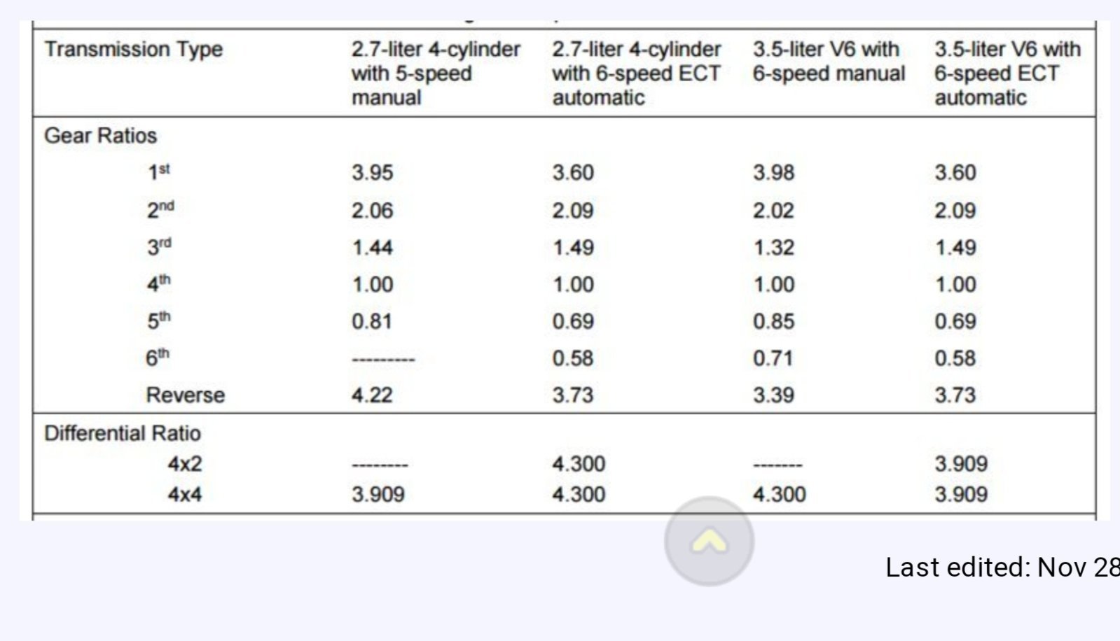

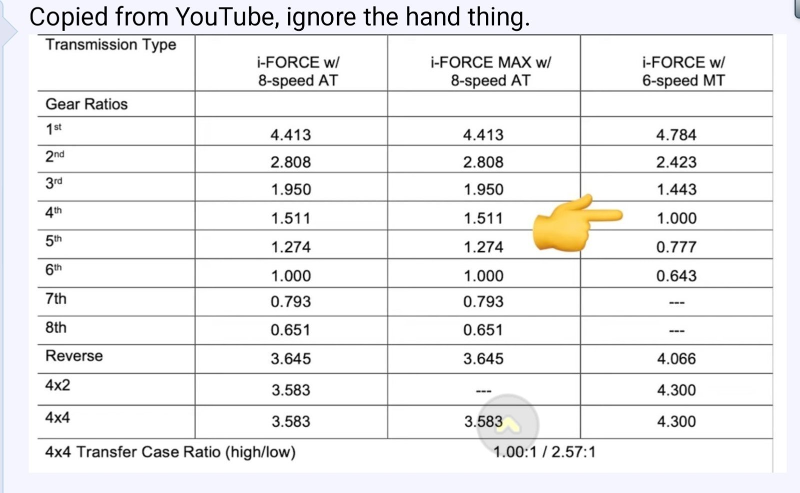

    Reverse looks much better in the 4th gen trans
