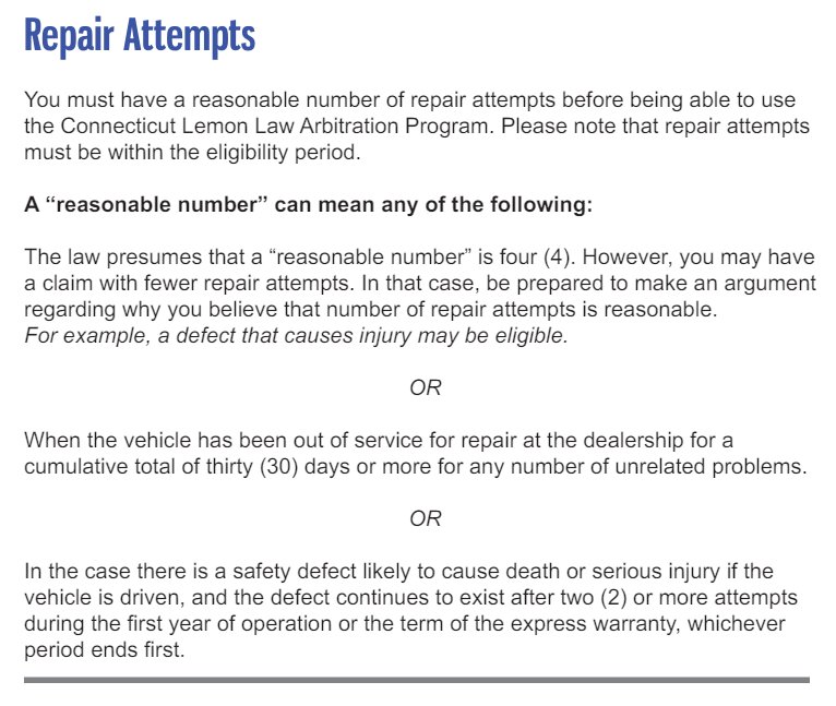

    I've never went through it before but isn't the lemon law only 30 days with out the vehicle? May want to try that I think each state is different.

    I'm in CT and it does look like if your truck is at the dealer for more then 30 days you can try the lemon law.

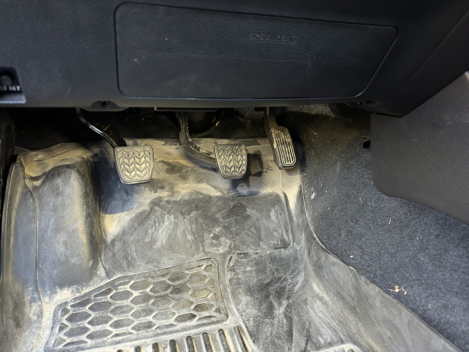

    I already swapped to the FJ metal pedal, I am not sure if the 2024 will be using the same part number pedal or not but it looks identical from what I can see below the dash in photos of the new truck. I am very happy with that swap, the pedal feels very secure and makes no noises. I forget the exact mileage I was at but I think I have around 15K on it now. Works great. I wrote a how-to write up on that one, check my started threads if you want to see it.
