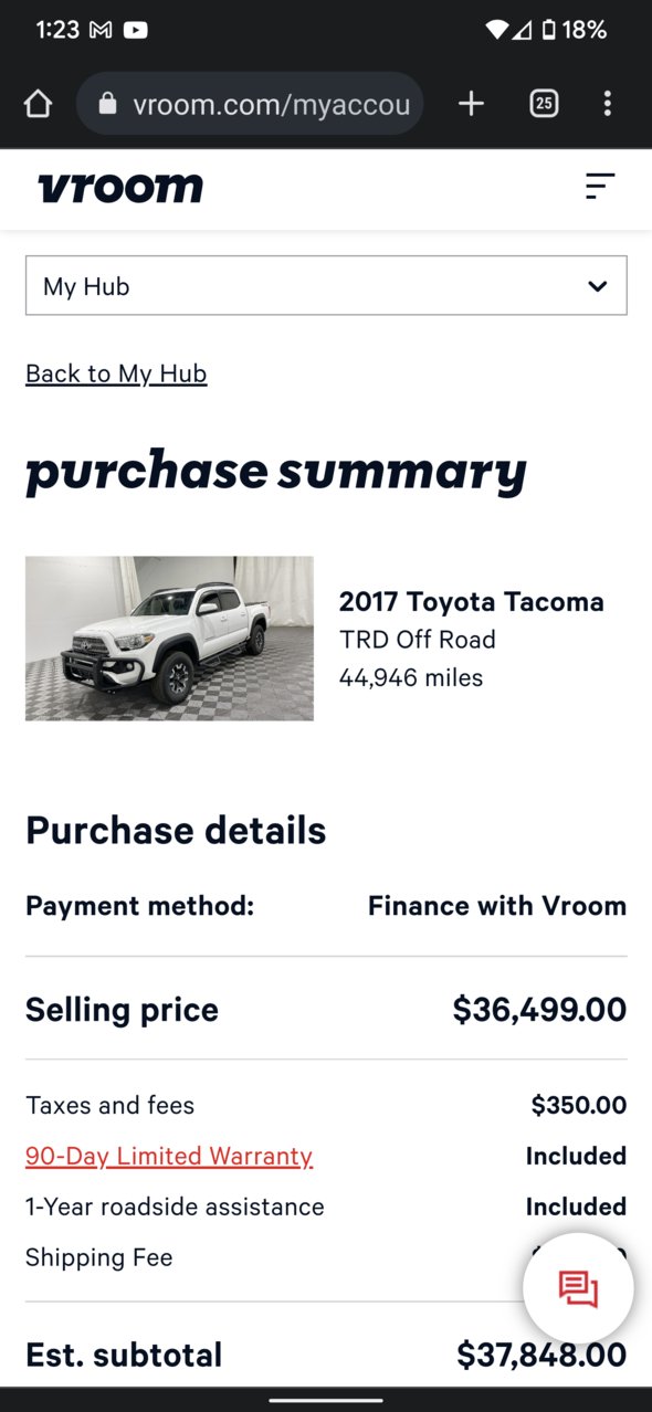

    Again, you didn't read. I just bought this Tacoma less than a month ago. The Jeep was also used. I don't have any problems keeping my transmission running well. These are problems I've inherited. Your just mad because I don't value your opinion.
    The problem is I've already heard 5+ times, and the Toyota tech who rode in the vehicle with me didn't have any problems with my shifting techniques, said it wasn't normal, and then scheduled me for a diagnosis next week. If it was as simple as not putting the vehicle into gear at 15-25 mph, then he would have said so.
    And the last vehicle that had the synchro replaced a month after I bought it, made a similar noise. Both of which had the noise immediately upon receipt if the vehicle.
    So please just stop with your incessant arguing. When I know a service tech has already debunked your theory. It's ok to be wrong dude.
