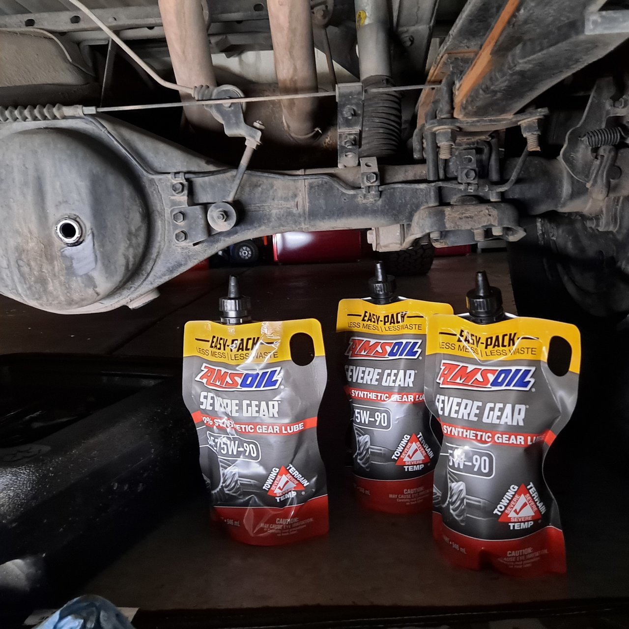

    I actually have a few empty Amsolil bags that I use for the diffs, so when it's empty and pour the Redline in the bag and it's a breeze that way too,
    Bags are soo easy

    Thats funny cause I did the same thing with my front/rear diff and transfer case.
    I also have easier and cheaper access to amsoil than MT-90

    Did my oil change today, added 60,000 since my last change,
    Those amsoil bags make the diffs and transmission a breeze
