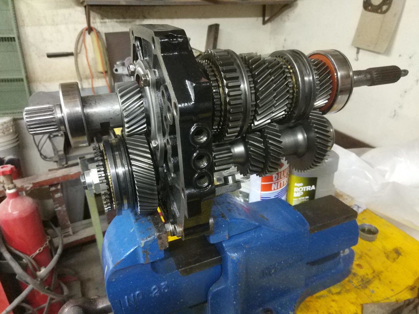

    I know the feeling, i’ve probably opened this transmission up 3 times trying fix the problem. that would be GREAT if you could find out what they did to fix it. is your truck a v6? if it’s a v6 i think you have the same R150F transmission as me. thank you so much

    Input shaft has bearings, counter shaft has bearings. Were they all replaced? What your describing really sounds like an internal bearing problem. When you push the clutch in at idle, everything stops spinning inside the trans, so the noise goes away

    hopefully it’s the lower one (i think it’s called the countershaft) with less of the gears and bearings pressed on to it. if you could find out for sure that would be so helpful!

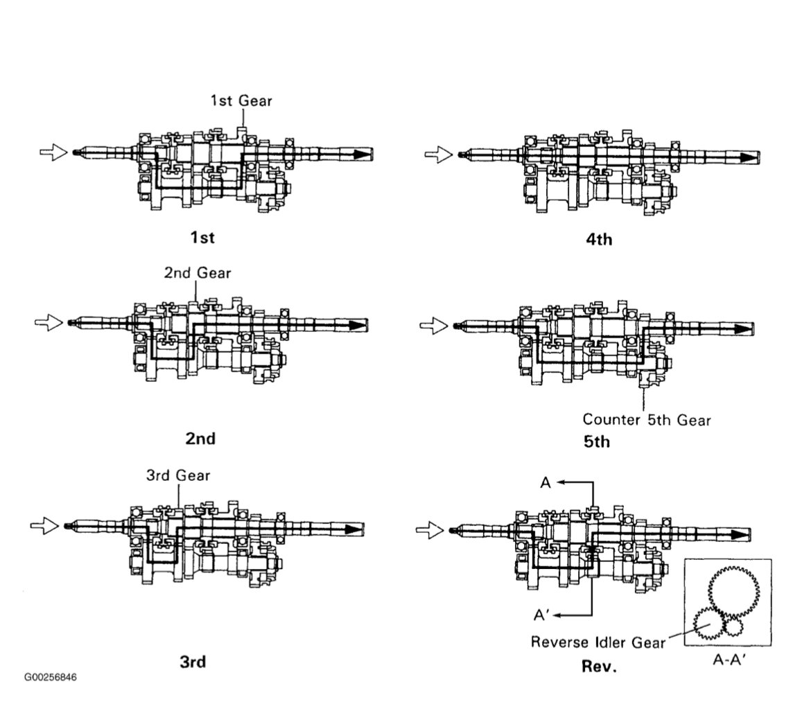

    Dang. so close. well there’s only 2 shafts that go in the transmission, they both have gears on them but i’m assuming(hoping) he’s talking about the lower one. It would make sense for it to be the lower one since the only quiet gear, 4th, doesn’t use it.

    Replace the Input and Cluster gear and the noise will go away.

    You seem pretty confident, can you elaborate please? or are you just telling me to throw more parts in hopes of it fixing it. Because i don’t know what an input gear or cluster gear is.
