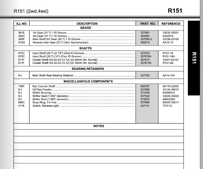

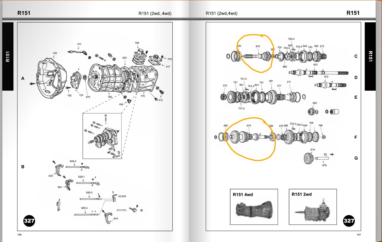

    The input gear to cluster gear surface is used in all positions except 4th. The mating surfaces become worn over time, you may even be able to see striation or wear marks if you look close. This will also be noisy in neutral with the clutch pedal released. These parts can be sourced at any manual transmission supply, price will vary. You will want to measure the 5th gear journal before ordering it will either be 28mm or 30mm.
