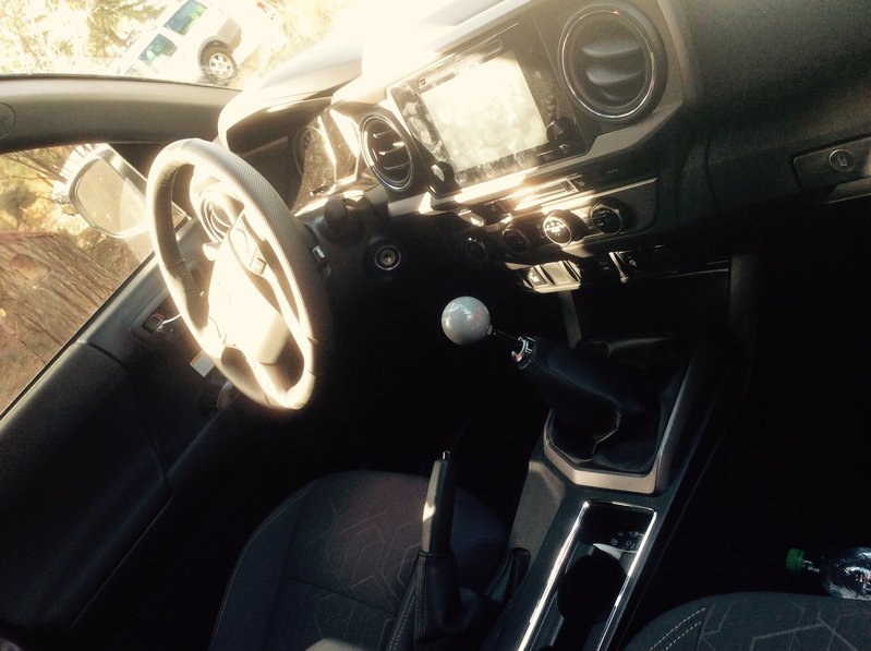

    I don't care for leather shift knobs. Is there anyone with a manual out there that can confirm the thread pitch on the shift lever for the 2016 six speed? Hoping it is not the same pitch as the previous models so that my TRD knob will fit (if my truck ever gets here ordered 10/23/15).

    Pretty sure I read somewhere that the TRD white ball handle fits the 16 .. can't say for sure where or if true!! I like the new shift knob. IF its leather its very stiff doesn't feel like leather to me.

    Trd knob fits fine. Just no insert part for boot ring, however rubber bands work great.

    For reference its a m12 1.25 pitch threading. Same as all toyotas and subarus
