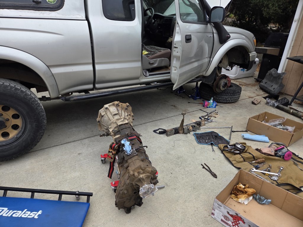

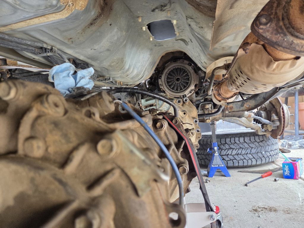

    I'll be dropping the transmission off at Yota1 on Monday.
    Gotta commend Toyota, that was really easy to get out. I understand the 4Runner of our vintage have space issues and you have to separate the exhaust.
    I didn't even need to touch my exhaust, it came out like a piece of cake.

    Awesome!! I wonder if the 2000 is different somehow from your 2001. My mechanic took my exhaust off when they did the clutch a year ago. Maybe they just did it out of habit.

    Nice pictures! I wish I could tackle mine but this is our only vehicle.

    When I split the transmission from the tcase, the tcase looked immaculate and the bearing/seal between them was not damage at all.
