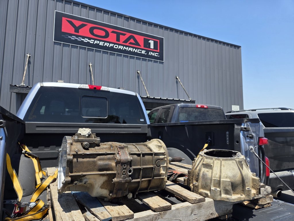

    Had a great time. Chatted with Joe for a bit and he called Nick out and we went over what we thought the problem might be. Nick is pretty certain it's the pocket bearing but he's going to exam the shafts. He looked over the Marlin crawler rebuild kit I bought 4 or 5 years ago to make sure the bearings were still good. He immediately could tell the seals and pocket bearing were trash non-oem, and the synchros were the wrong sizes, and one of the bearings was the wrong size, they gave me 3 third gear synchros... It's possible I may have bought the wrong kit 4 years ago.. So I'm glad I didn't do it myself with those parts cuz I either would have got stopped or fucked up. They're going to harvest the synchros and bearings that I can't use in shop which I'm glad they're not going to waste.
    I'm going with the dyna 5th gear upgrade, and I may go with the new low 1st and 2nd I'm still deciding. If the counter shaft needs to be replaced I will def get the new 1st and 2nd.
    Joe took me on a tour and showed me a bunch projects and what they're working on in the shop, it was a good time.
