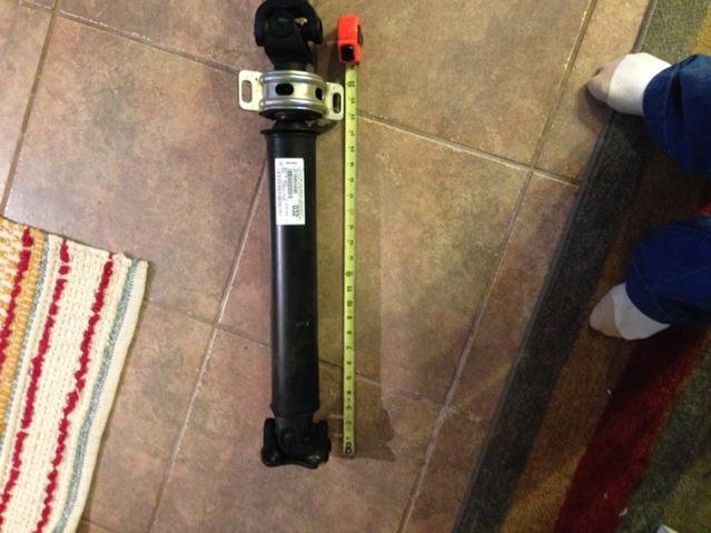

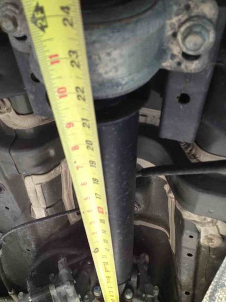

    Just a few little things. It's my DD
    Maybe this will help?
    09 ac cab auto

    Now measure yours and see if same. I measured off the flat plate that mounts on both ends.

    Hooked it on the outsides. You can kinda see in one pic where I hooked. Was the easiest way to hook.

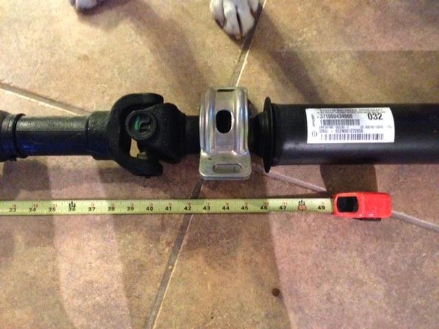

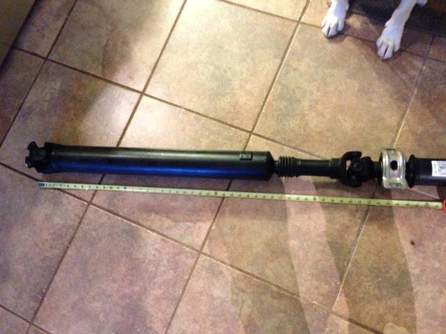

    gotcha....
    i just measured by pressing the end up against the flanges/plates and got:
    2006 AC TRD Off-road Manual
    23 1/2" and 45 1/8" to the center of the hole at the bottom of the carrier bearing
    dk how thick those flanges are...i can remeasure in a minute (appear to be about 3/16" or 1/4" thick)
    looks like my carrier bearing bolt is close to the middle of the bolt hole which is 1" elongated
    also noted there there are two mounting locations for the carrier bearing, 2.5" apart...mine is on the furthest back.

    kind of looking like the auto has a shorter front section than the manual

    Looks pretty close to what mine was and it looks like mine is mounted in the back hole to. You can see that in the pic. I zoomed in where I hooked the tape and I hooked the same on the front. To the prefect round plate. I hook on the outside where I could use one hand and take the pic. By you measurements it looks like there the same. If you where inches off I'd say no but it looks like the same ImageUploadedByTapatalk1357247318.228461.jpg

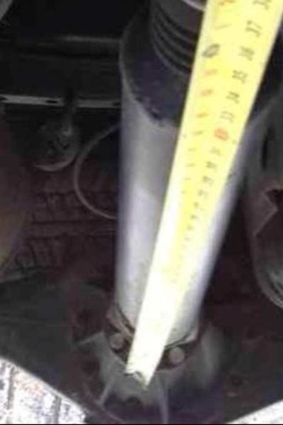

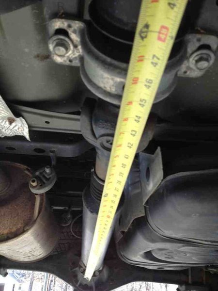

    measurements from a 2010 DCSB auto
