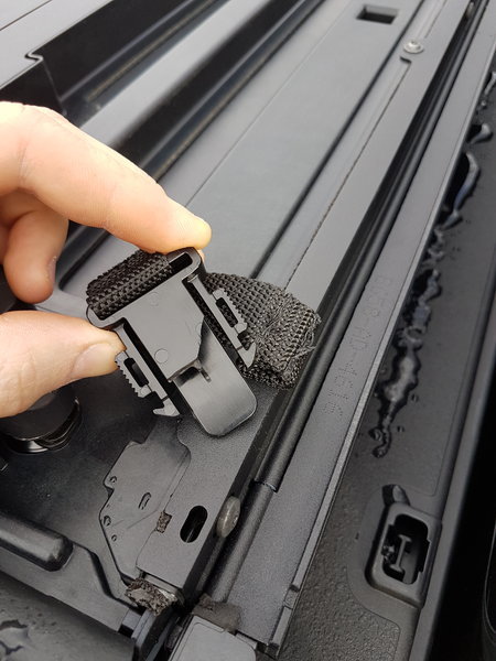

    I need a new one of the retaining clip things for when you have it open.
    forgot to put the clip on the snap part for when not in use on the passenger side and closed it, got caught between a bed cleat and the cover and now its broken.
    Haven't even asked the dealer about it yet as the strap is riveted on so I'm almost thinking its not something that can easily be replaced.
  18. Jan 29, 2017 at 11:06 AM
    #38
    Joe23
    Joe23 Canuckistikian
    Oct 5, 2015
    #165909
    11,299
    The Great White North
    2017 TRD Off-road DCSB
    Actually just went to look at it and noticed where its riveted has a bunch of screws in it so looks like it would be a replaceable part, but who knows what the dealer would charge me. After all I did this myself, not going to be like some that have posted on here how they broke something and expected the dealer to fix it for them under warranty.
    It still actually holds but is a bit loose, I tried tugging on it to get it to come free, nothing would without pressing the side tabs, and from how little I'll ever drive with it open not sure its even worth it.
    Just fitting the 4 factory tires in the bed with the cover on was a pain in the ass and had to keep it open, pretty much any time I have to move stuff I'll likely just remove it.
