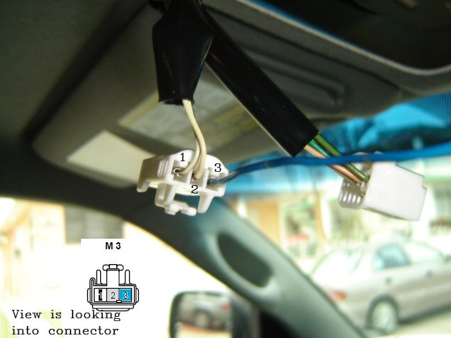

    How's it going Caribe Makaira quick question for you, So I recently purchased a 2007 tacoma map light for my fj cruiser (which does not have a map light at all) so I am going to wire it from my center dome light. Looking at the diagram that you have for the map light connector I want to make sure I understand it right. So for the Mod'd version M3 connector the middle pin (#2 is constant power) (#3 is door) and (#1 would be ground). Correct me if I am wrong.

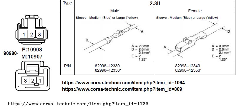

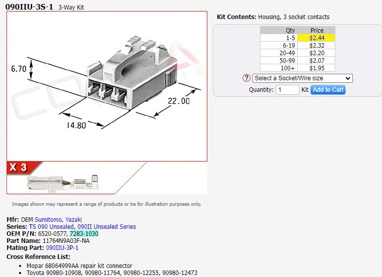

    My issue is that the head unit I ordered didnt come with the connection clip so I was going to make my own and I would need to know which number correlates to " ground, current and door". to my understanding (3 is door) (2 is constant power) and (1 is ground)

    You are correct:burp:

    Connector to map lamp console 90980-10908

    Perfect, ill order it up now and post some pictures once I get it installed. Thank you again!
